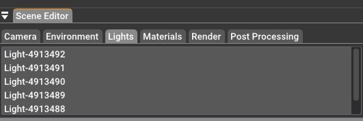

          Hello,
          Is there a way to rename the lights? I'm lost, I can't adjust the intensity of a new bulb because they are numbers and I have to activate or deactivate each light to locate them.... thank you
          The lights take the names of the light components. Maybe I can add the option to rename the lights in Rayscaper itself?
          I renamed the light sphere component and that's not the right solution, it disabled them all. And now I can't add any more light spheres, only the spotlights work...
          This feels like a bug, do you have a way to reproduce this?

            • KrassK Offline
              Krass @Krass
              in this scene, a series of bulbs of the same type and two others for the individual lamps. And I end up with the list of numbers if I want to adjust the intensity... it would be necessary to have noted the number of each light that we add...
