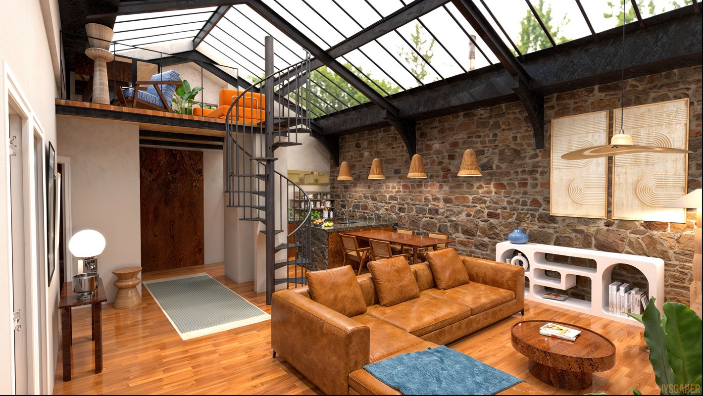

                                      Krass
                                      an old project, rendered with Rayscaper photoshop retouching and AI upscale
                                      Krass
                                      Reply Quote 2
                                      • KrassK
                                        Krass
                                        new project with last rayscaper version and light upscale
                                        Krass
