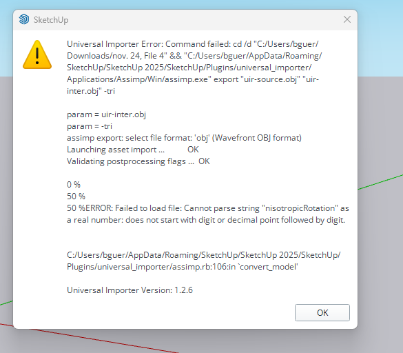

                                  • B
                                    BGUERRE
                                    hello
                                    thank you to provide universal importer to the SU community.
                                    Unfortunately, i did try to dowload .obj file, but get the following error message
                                    OBJ fil is about 16 MO and he was generating by 3D Snap an IOS app.
                                    Any suggestion ?.
                                    thank you
                                    Bruno
                                    samuel_tS 1 Reply Last reply
                                    • samuel_tS
                                      samuel_t @BGUERRE
                                      @BGUERRE Hello,
                                      You're welcome!
                                      Seems there's an issue in .MTL file paired with .OBJ file.
                                      Can you please upload them and send me both (in private if you prefer)?
