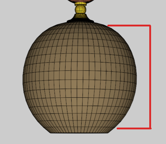

              I wold be curious to se a wireframe of it.

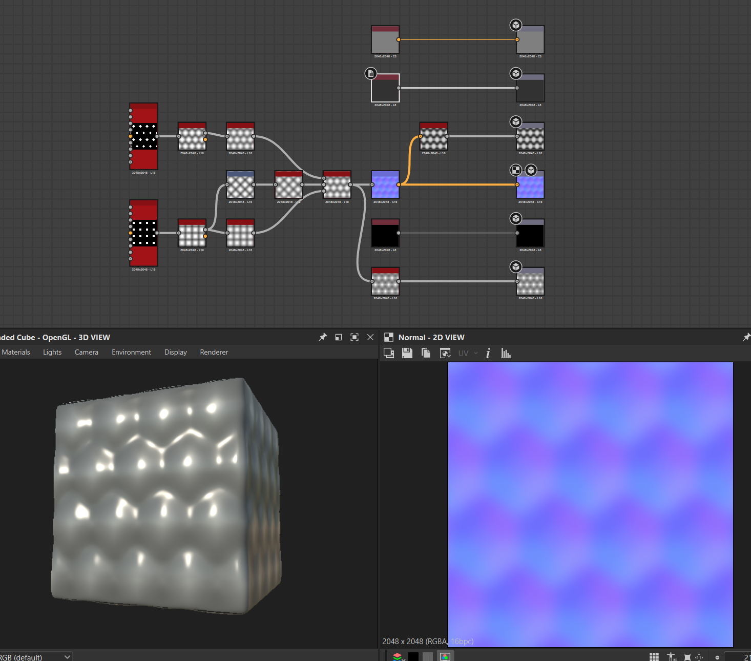

                @panixia Its a normal map I made in Substance Designer that I then played with the UV scaling to get the look needed.
                  The wires...
                  Pretty basic stuff tbh. It was more the materials doing the heavy lifting and a nice studio HDR

                    @Rich-O-Brien you used spherical UVs?
                      @panixia the bump only needed to reside with this area so I did flat unwrap for this portion
                      So the object had 2 glass materials

                          @Rich-O-Brien Pretty straight forward..
                          I'd expected a more noticeable distortion.. so I was fancying about about geospheres or some other funny way to over-complicate life
