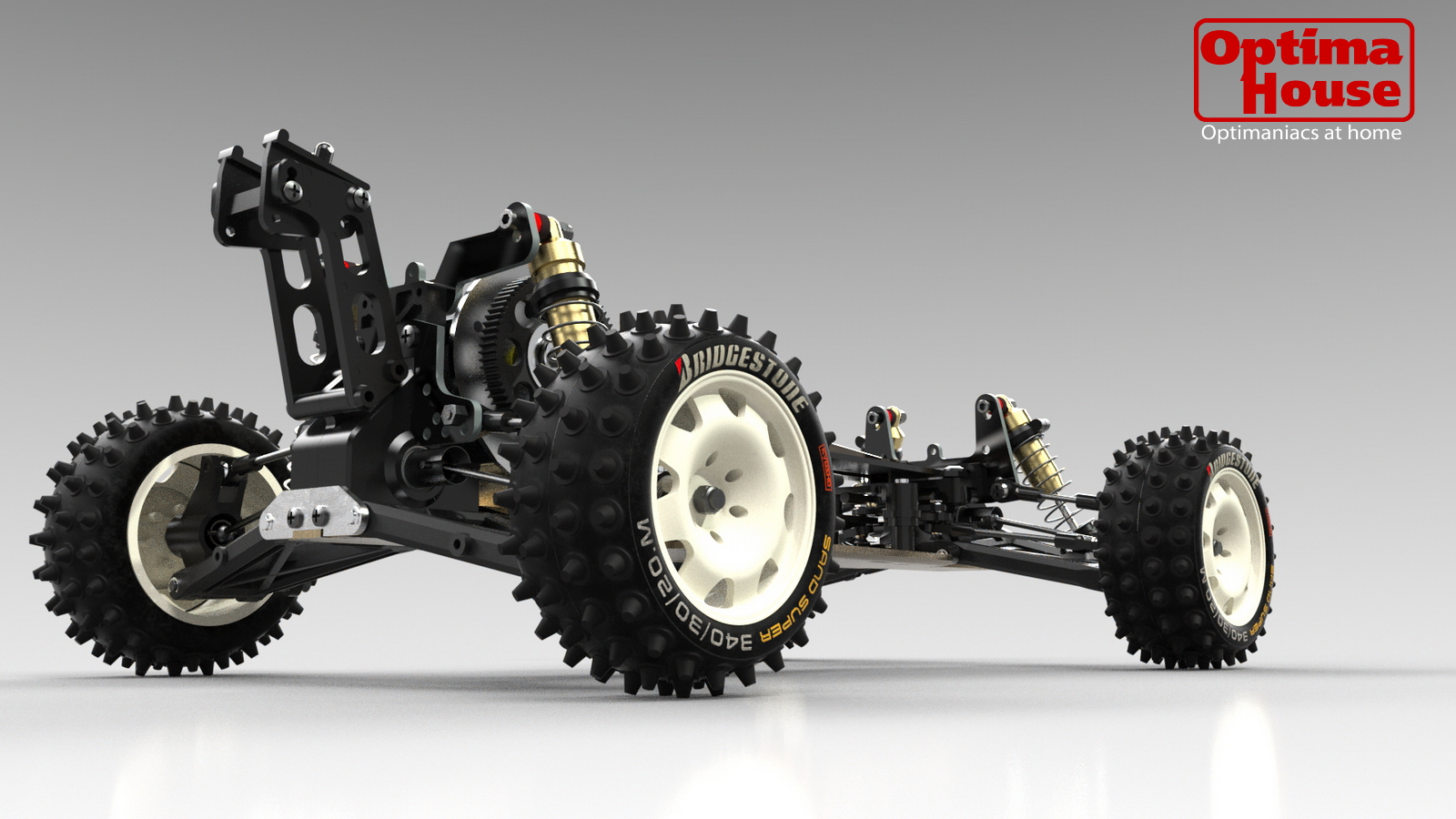

      Cool... I finally did it. πŸ˜„
      The chassis is an old model of my Javelin I made with SketchUp 4.
      I never quite succeeded in modeling the Optima body (lexan) because of the tools lacking in SketchUp, but with the recent addition of SubD and QFT, I was confident to be able to model it correctly.
      Yet I missed an unwrap tool as I didn't want to go the 3dsmax way to make all the complex painting scheme, not to mention the rich decals.
      Sketchup 2017 + SubD + QFT + WrapR + Substance Painter 2.6 + Thea Render 1.5 + Photoshop
      Kyosho Optima by optimaforever

                          Another example... Here I only WrapR'ed the tires and painted them with Substance Painter, then exported back the texture to Sketchup, rendered with Thea...
                          Previously I had to add the markings with PS or stamp the text as vector shapes in raw sketchup geometry.
