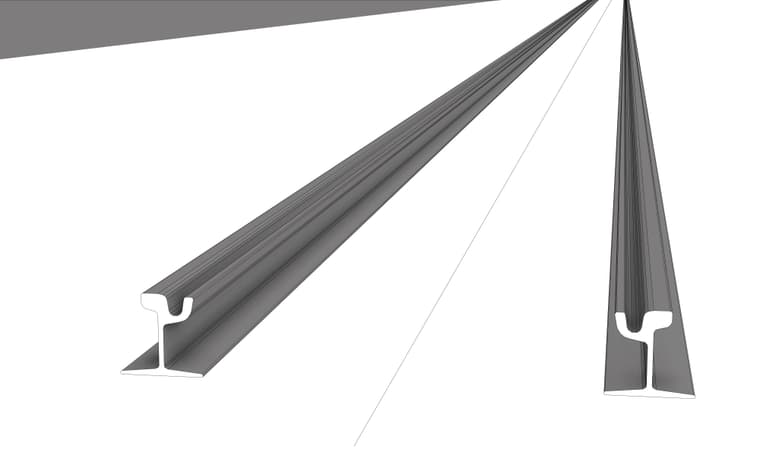

                        is there a Pugin to draw rails along path?
                        http://www.zz7.de
                          ProfileBuillder would be a good option.
                          Or CurviLoft
                          CurviLoft to make profiles follow a curve in SketchUp
                          • jo-keJ
                            jo-ke
                            I am using profile builder 1 but there is no option for rails
                            http://www.zz7.de
                              I can't remember v1 but v3 has an Along Path option that has rudinmentary support for branching paths.
                              Using ProfileBuilder 3 in SketchUp to draw train rails
                              • jo-keJ
                                jo-ke
                                I need a path in the middle and two rails (special profile) left and right, to follow the path.
                                http://www.zz7.de

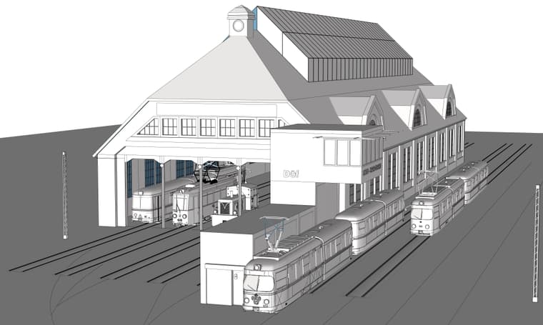

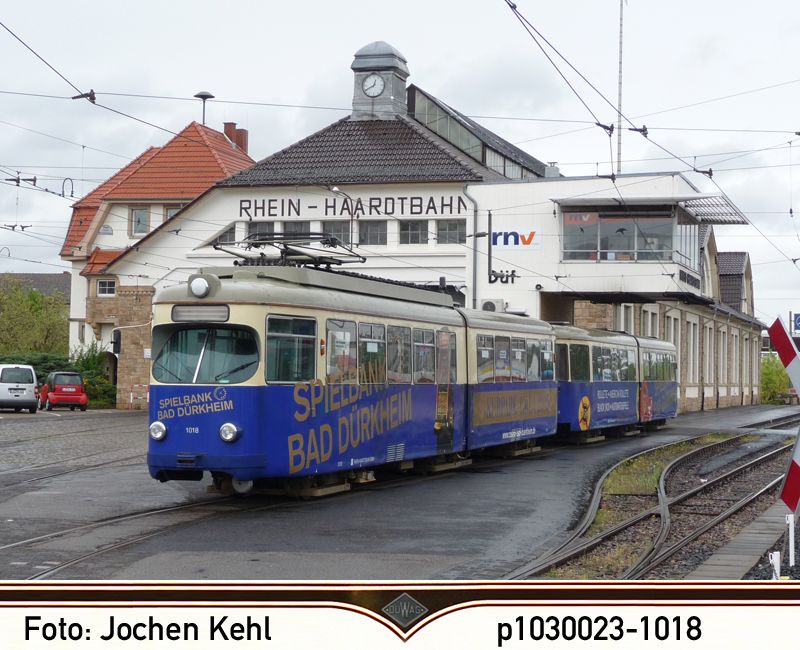

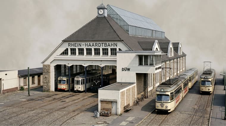

                                • jo-keJ
                                  jo-ke
                                  next project
                                  photo:
                                  SU:
                                  Render:
                                  http://www.zz7.de

                                    Curviloft does a good job to be fair, not sure why you need anything else. Upright extruder perhaps (Or whatever it is called now).
                                      Rich O Brien Moderator @jo-ke
                                      With Curviloft the profiles can be offset from the path...
                                      Profile offset from Path using CurviLoft
                                      That does mean you need to do each side as a separate operation.
                                      Or with ProfileBuilder 3 (or above) you could make an Assembly with a mix of Profiles and objects like bolts to do it in one sweep.
                                      TIG's Extrusion Tools would do it too similar to CurviLofts approach.
                                      • jo-keJ
                                        jo-ke
                                        the newer version of profile builder seems to be a good tool.
                                        Is it possible to insert an own profile?
                                        http://www.zz7.de
