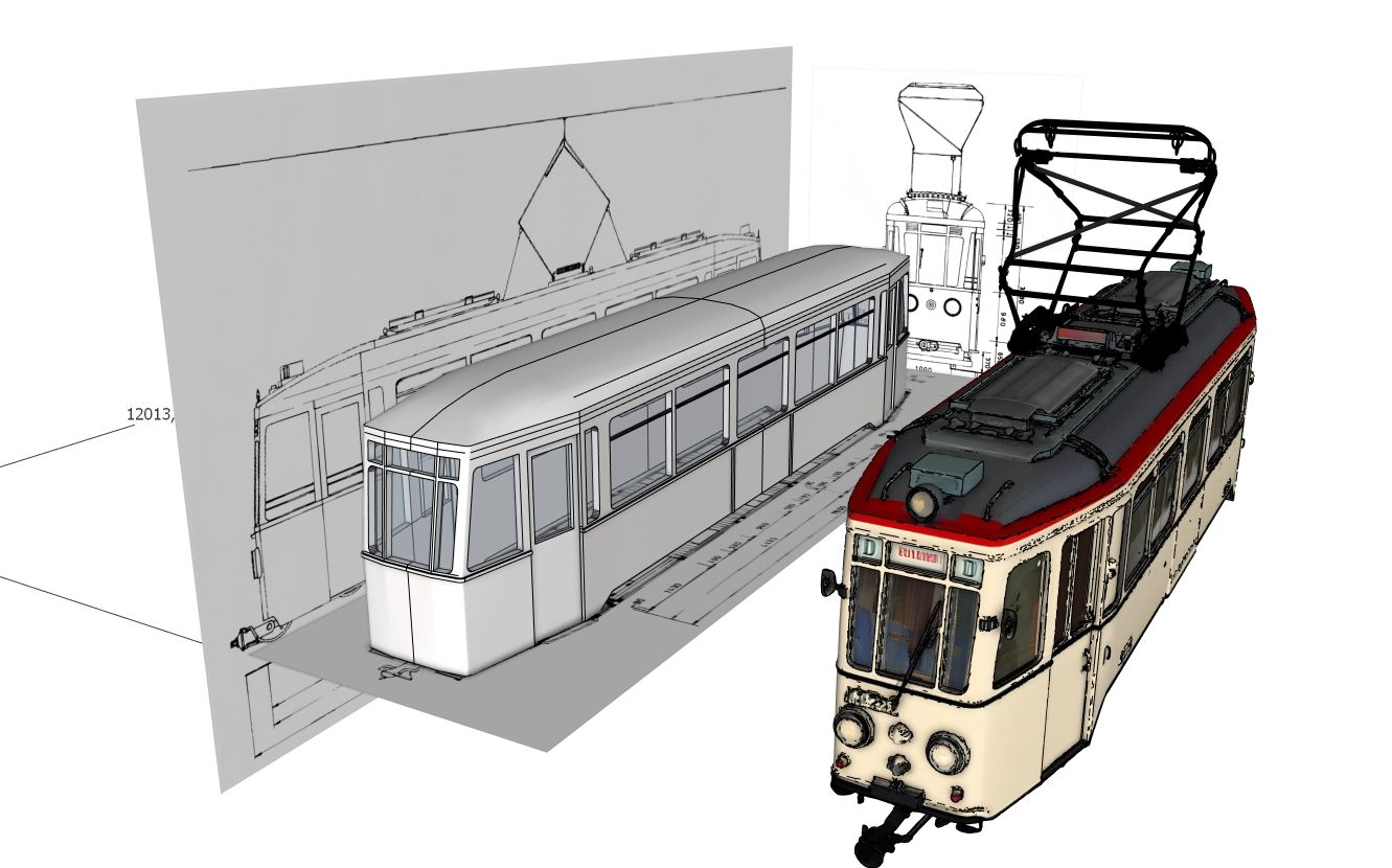

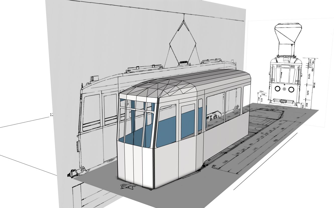

                        I started to model that tramway for a 3D Print.
                        Meshyscan in foreground
                        http://www.zz7.de

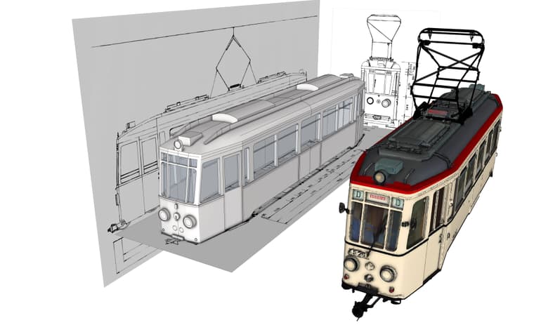

                          3D Model is finished:
                          this is how the finished model should look like....
                          http://www.zz7.de

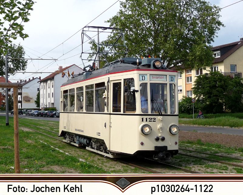

                                        next project
                                        photo:
                                        SU:
                                        Render:
                                        http://www.zz7.de
