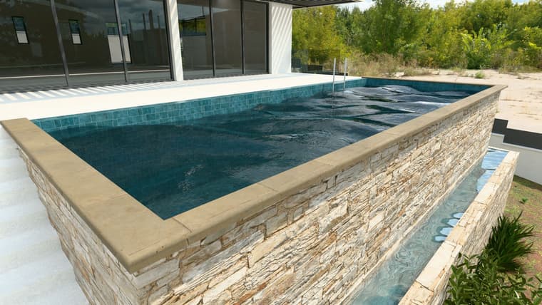

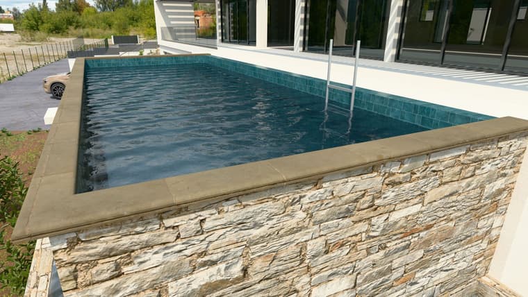

      The pool on the screen is an "infinity pool"; I wouldn't have the patience right now to model that in SketchUp... then again, maybe I would? But AI does it in a couple of quick moves.
