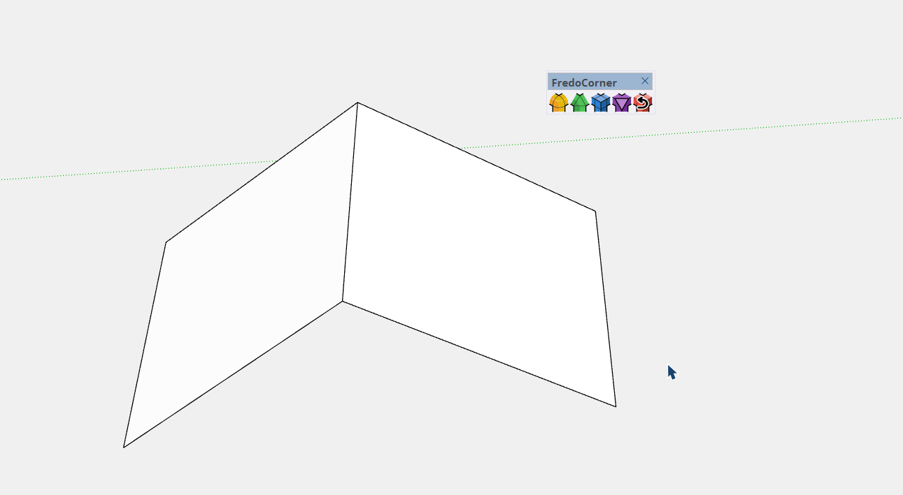

                    Hi there! I was curious if it's possible to round a corner with an uneven offset? I'm looking through guides and documentation, but I figured it would probably be easier to just ask the source directly instead of spending a couple hours researching a feature that might not even exist. Thank you for your time!
                    G 1 Reply Last reply
                      Click the edge and type the variable offset in the VCB as either a length/radius or %

                        GraceMien Newcomers @GraceMien
                        Oh awesome! Thank you so much for such a quick and helpful reply. I really appreciate it.
