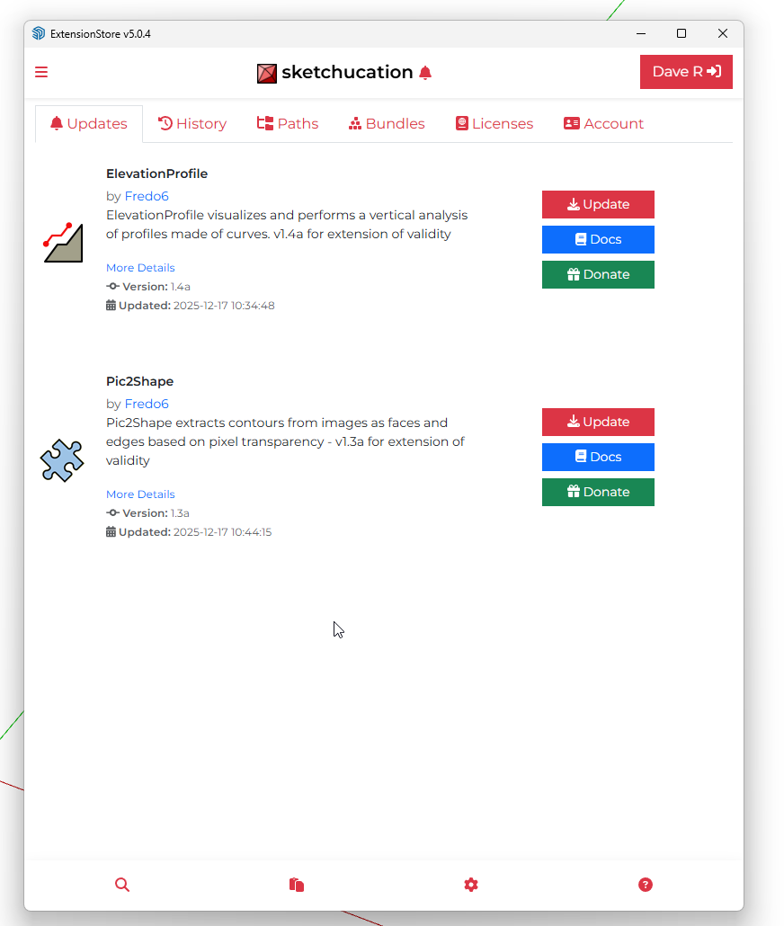

                                    Maybe I'm missing something but I don't see the Update All option from earlier versions. Was it removed?
                                    G 1 Reply Last reply Reply Quote 0
                                      I had it but noticed it was not correctly the other day.
                                      We will take a look now.
                                      • G Offline
                                        Gábor @Dave R
                                        @Dave-R We haven't removed it, for me it is displayed correctly. When you have a few minutes to test, please PM me.
                                        Dave RD G 2 Replies Last reply Reply Quote 0
