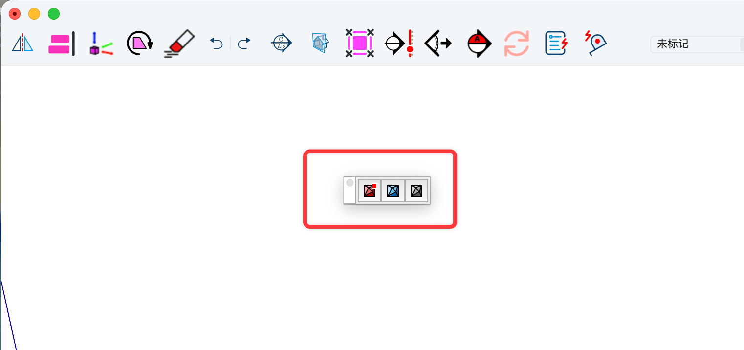

              After upgrading SketchUcationTools to version 5.0.3, the Extension Store toolbar keeps appearing in the same spot every time I launch the software—even after I close it. Is there a way to fix this?

                  TIG Moderator @Wantao
                  @Wantao
                  The red dot on the toolbar button shows shows that updates are available.
                  If updates are available then the toolbar shows up by default even if you have closed it previously. This is to ensure you see the availability.
                  However there are two options in the Extensions > SketchUcation submenu, covering the toolbar close/open status. The first is the same as opening/closing the toolbar manually with the update-availability auto-opening it later if appropriate, but the second one let's you close it and then ignore update alerts, it you choose that you need to manually check for updates by opening the toolbar or ExtensionStore dialog.
