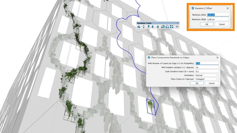

I am adding a small picture impression of the production process. In addition, I also wrote a small sloppy and imperfect ruby (rb) plugin that allows selected components to βfloatβ within a self-defined range at random Z heights. Similar to a deck of cards thrown on the floor. To prevent the PNGs (the cards) from interfering with each other, each PNG must have its own determined random height in cases where these cold be coplanar with any other to avoid any coplanar glitching issues...

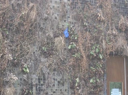

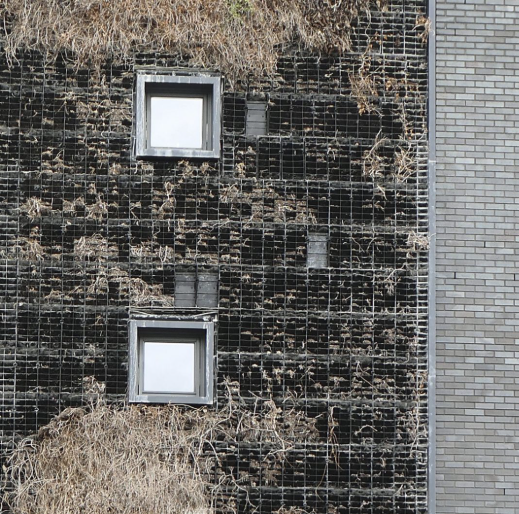

Ask away mate, bottom line is as much as I am a big fan or urban greening in general for so many ecological reasons. I think in practice they are a nightmare on so many levels, Having a lot of experience i this field as a systems designer I do not thing the are practical. and one hole in that waterproof membrane either vertically as in green walls or horizontally as in green roofs Green roofs being the lesser evil of the two.
In reality we all know as normal building age buildings age things go wrong and damp is a big problemI do not believe the hype any more. Look up french green wall designer Patrick Blanc I believe he is the leader in this field

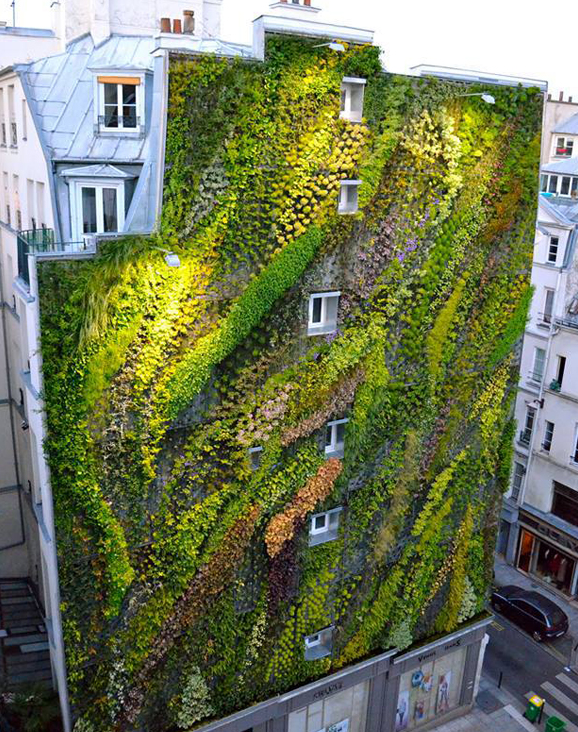

This is one work by Patrick -
The cost of this would be about (In Australian Dollars)
Installation: $1,000 β $2,500 per mΒ²At ~5 stories, say the wall is 15 m wide x 20 m high = 300 mΒ²
Thatβs $300,000 β $750,000 AUD installation cost.
Ongoing maintenance: $100 β $200 per mΒ² per year
Around $30,000 β $60,000 AUD annually for upkeep.
Lighting & irrigation system: included in the above, but can add $50k β $100k upfront depending on complexity.

This is one work by PatrickWow !!! I recognize the picture without knowing who created it.
And what a great piece of work by himβnot just green for its own green sake, but truly artistic. -
Agreed beautiful study of how nature colonises species
Agreed, my one problem would be complaints and potential suits from folk who have their windows obscured from daylight. Perhaps cut down on the foliage quantity a bit.
Like I said mate it is so expensive to build and maintain
I can definitely see that this sort of thing is NEEDED, for water recycling purposes if nothing else. I saw a project in Manhattan where the planting from top to bottom of a tower block was used to reclaim brown water produced by residents. Lots of room for projects like this to manage hotter climates without massive energy drain.
We can do this if the will (Power) is there. -
