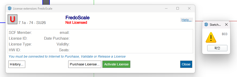

                              I purchased a paid license for FredoScale and am currently using it on one computer, but I keep getting errors when I try to install it on another computer. Could you please help me resolve this?
                              I already deleted everything and reinstalled it.
                              The error codes keep appearing alternately as 02, 03, and 04.!
                              • TIGT
                                The B errors relate to license file issues.
                                Rich will comment in detail.
                                Have you copied the .license files over to your new PC ?
                                Have you tried activating the license [green button] ?
                                Have you logged in and checked your used licenses under the SketchUcation.. PluginStore > My Licenses page ?
                                G 1 Reply Last reply
                                  Rich O Brien Moderator @gna young
                                  The errors are all signature file related. It might be that SketchUp does not have read/write permissions.
                                  You can fix that by repairing SketchUp's installation.
                                  Download the SketchUp installer. Right click the .exe and choose Run as Admin nd when prompted choose Repair.
