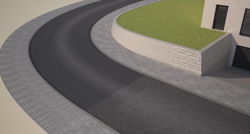

                Hey Fredo,
                Thanks a lot for the great plugin! You are a hero.
                I have a slight problem tho. I used your plugin and in sketchup it looks like this
                http://www.citypixels.be/wp-content/uploads/2012/10/sketchup-thrupaint-01.png
                but when I render it in Maxwell Render it looks like this:
                http://www.citypixels.be/wp-content/uploads/2012/10/simpel-huis-render-017.jpg
                The yellow stones in the little wall have become much smaller and the middle part of the street has become darker. Do you have an idea what the problem could be?
                Thanks!
                Pieter
                This is my website:
                Citypixels - 3d Visualisatie Architectuur
                • TIGT Offline
                  Check if the two surfaces have the material applied in a different way.
                  I suspect that one has the material applied to the face itself while the other has the material applied to the 'container' [group/component-instance] - check this by using 'Entity Info' and selecting the actual faces in each case - the 'mapping' cannot persist into exported formats when applied to a container rather than the face itself... Of course it might be a Maxwell issue with it mis-handing the UVmapping ?
                  • thomthomT Offline
                    thomthom
                    Contact Maxwell support - as this is their render engine that doesn't properly process the UV mapping.
                    • pietervP Offline
                      pieterv
                      I have checked, and the two materials are axactly the same. I have the free version of Maxwell Render, so I'll repost this under "extensions & applications". Thanks for answering!
                      This is my website:
                      • thomthomT Offline
                        thomthom
                        I'd still recommend you contact Maxwell - as this would then be something that presumably affects all users. Reporting issues to the developers is important - otherwise it'll never get fixed.
