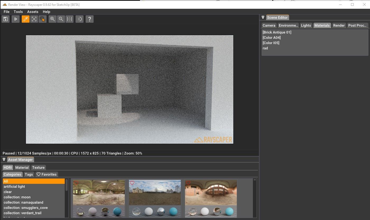

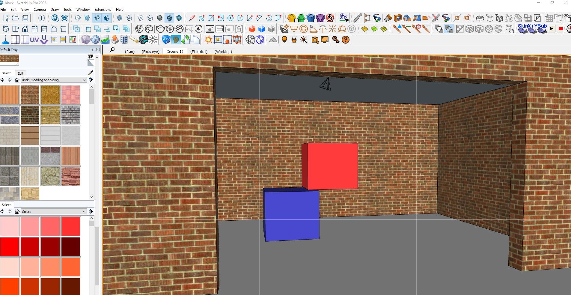

                                      @pixelcruncher I've just downloaded the latest version but now cannot get any materials to show up at all. Using the colour picker tool doesn't highlight any material in particular. Everything else seems to work, just no textures on renders..no colour.jpg textures.jpg

                                          pixelcruncher Extension Creator @nickchun
                                          @nickchun Sorry about that!
                                          Are the materials directly assigned to the faces, or are they assigned to the component/group? If you assign a material to a component/group, then they are not applied to the face. That's a regression reported by @sashapepperspray last week, but I haven't addressed it yet with this release.
                                          Can you confirm that this is the problem, i.e., that the problem is fixed by directly assigning materials to the faces? You can use Fredo's Thrupaint to make it easier: https://sketchucation.com/plugin/2561-thrupaint.
                                          If that doesn't help, there's something seriously botched in this release, and I will investigate further. Anybody else seeing this?
