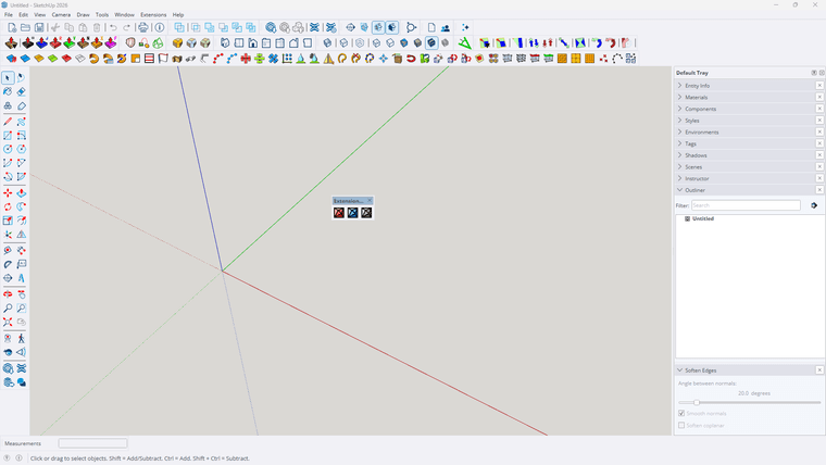

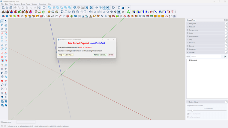

                  I have recently upgraded to sketchup 2026 and my laptop to windows 11. Up till today my Fredo^ plugins have been working fine, until today. I have the prepetual licences for all the plugins, and when I want to use them I get a window saying - TRIAL PERIOD EXPIRED etc etc. I have removed all the files from my PC, and reinstalled Fredo^ and all the plugins from my licence profile on Sketchucation. I have restarted sketchup and still receive the same notification. What must i do next please. Can admin assist?
                  Dave RD R 2 Replies Last reply Reply Quote 0
                    Dave R @GavinG
                    @GavinG do you have the latest version of the Sketchucation Extension Store installed?
                    • G Offline
                      GavinG
                      I think so, I have 3 new icons on my ribbon ( see attached). This is where I get directed when looking for Sketchucation Extension Store
                          First, when you have a problem of license, do not try to reinstall. Just check you have the latest versions.
                          Also, if you get the message of expiration, try first to revalidate the license. It won't count for a new seat.
                          Does it work in your case?
                          G 1 Reply Last reply Reply Quote 0

                                  @fredo6 - I have tried to uninstall and reinstall, no luck, I have just installed the plugin as indicated below in the next reply, still nothing working. I still get the TRIAL PRERIOD EXPIRED window
                                  fredo6F 1 Reply Last reply Reply Quote 0
                                    fredo6 @GavinG
                                    @GavinG
                                    When you get the expiration message, did you try to click on the button 'Manage License' and revalidate the license (using the file you received by email when you purchased the license)?
                                    If you do not have the license file, you can retrieve it and download it at https://sketchucation.com/webshop/my-licences.php. Just sign in.
