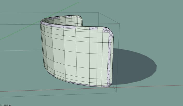

            Hello, Freddo. Amazing job, thank you. I have a question for you, is it possible to save the grid in squares using FredoBend by disabling the Slicing tool? Currently, the plugin removes unnecessary geometry at the end of its work, and it is needed for further use of the SubD.

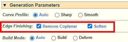

                  I am also introducing an option for
                  • softening edges or not
                  • removing coplanar edges
                  New version will be published later today.

                          FredoBend 1.2b is a maintenance release including:
                          • Bug fixing
                          • Parameter for softening edges and removing coplanar edges

                          • A Offline
                            AISmebel
                            the triangulating line that appears after using the plugin should become soft+smooth. Then the squares of the SubD work. Now the following is happening:
                                I am not sure it is possible to identfy and carry over the quad mesh, because of the slicing.
                                Could you send me a model and a curve so that I see what can be done. Thanks.
