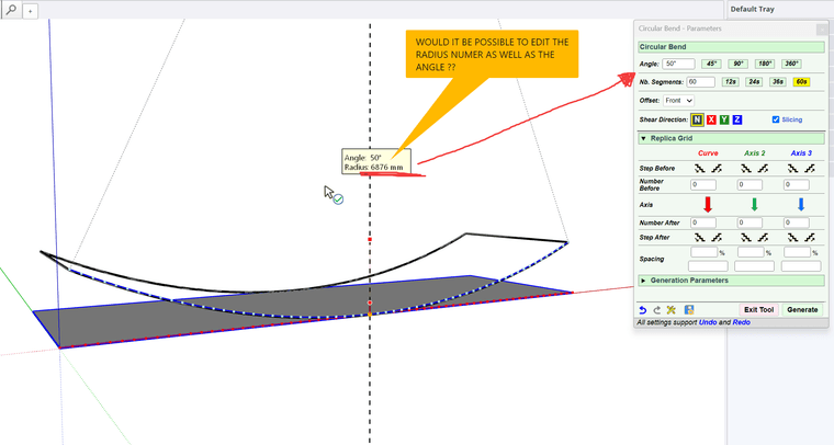

But made here :<br />
<img src="/assets/uploads/files/1774724301314-image_2026-03-28_195820438.png" alt="image_2026-03-28_195820438.png" class=" img-fluid img-markdown" /></p>
