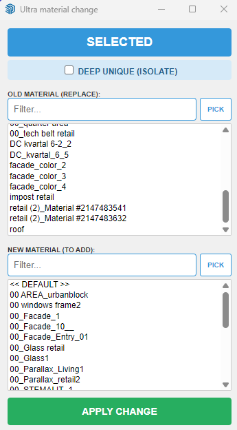

      Krass @Berserk
      @Berserk said:
      The ability to isolate the selected by making it unique. At the same time, the connection between the copies of the components inside the selection remains
      this won't work on my SU 2024...
      Sketchup says in the entity information that they are still the same components, but in reality they are no longer linked; the geometry modifications I apply after choosing the Deep Unique mode to change the color do not take effect....

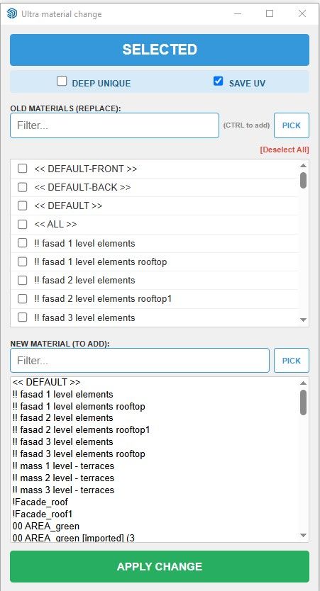

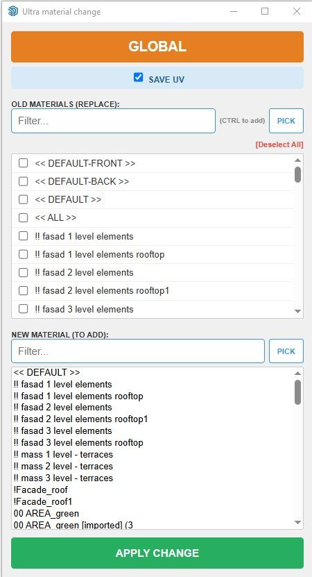

                Updated the Material Change plugin. Changes:
                • Added the ability to replace several materials at a time (using a selection in the list or with a pipette when pressing Ctrl)
                • Now the plugin can save texture transformations or reset them.
                • Added a reset button for selecting old materials so as not to uncheck manually.
                • Hints have been added to the status bar at the bottom of the sketchup window to understand whether you are currently choosing old or new material.
                • Now the plug-in window will not close after pressing Apply (convenient when you need to make several substitutions in a row)
                • I drew my own eyedropper, otherwise I used to have a pencil))))
