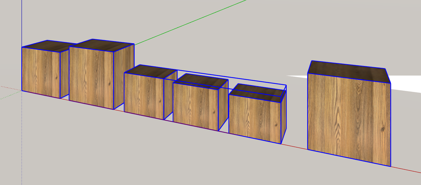

                @TIG I've tried but it doesn't work. I'm attaching an image as an example where I've modified the scale of each cube and also the scale of a group that contains three cubes. In practice, I would like that once all objects are selected, I can define the scale for all of them, even those nested inside the group.
                • TIGT Offline
                  Once you have a collection of selected 'containers' [groups and component-instances] you need to go though that array and do the same again to each 'container's' entities, selecting any new 'containers', repeat this until all nested 'containers' are got.
                  Here's an outline of an example...
                  def miner(entities=Sketchup.active_model.to_a)
                    containers = [] #an empty array
                    entities.each{|e|
                      next if ! e.is_a?(Sketchup::Group) || ! e.is_a?(Sketchup::ComponentInstance)
                      containers << e.definition
                    containers.uniq! #ignore duplicates
                    #process the containers
                    containers.each{|e|
                      #do scaling code on 'e'...
                    #containers is an array of selected groups and component-instances' definitions,
                    #BUT not any that are nested.
                    #Next go through the container.entities -
                    #this repeats until there are no containers left to process.
                    return nil unless containers[0]
                    containers.each{|e|
                      miner(e.entities) #repeats itself !
                  end#def
                  #run with miner(Sketchup.active_model.selection.to_a) after first making your selection...
                  alexpacio2013A 2 Replies Last reply Reply Quote 0
