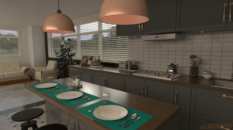

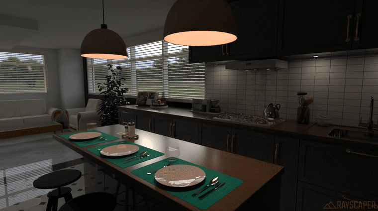

      Well, I think the latest buil;d works well enough. The problem textures have been replaced which seems to fix the non rendered facets issue.
      I have added some flame effect underneath the kettle and adjusted the emmision qualities of the pale yellow texture.

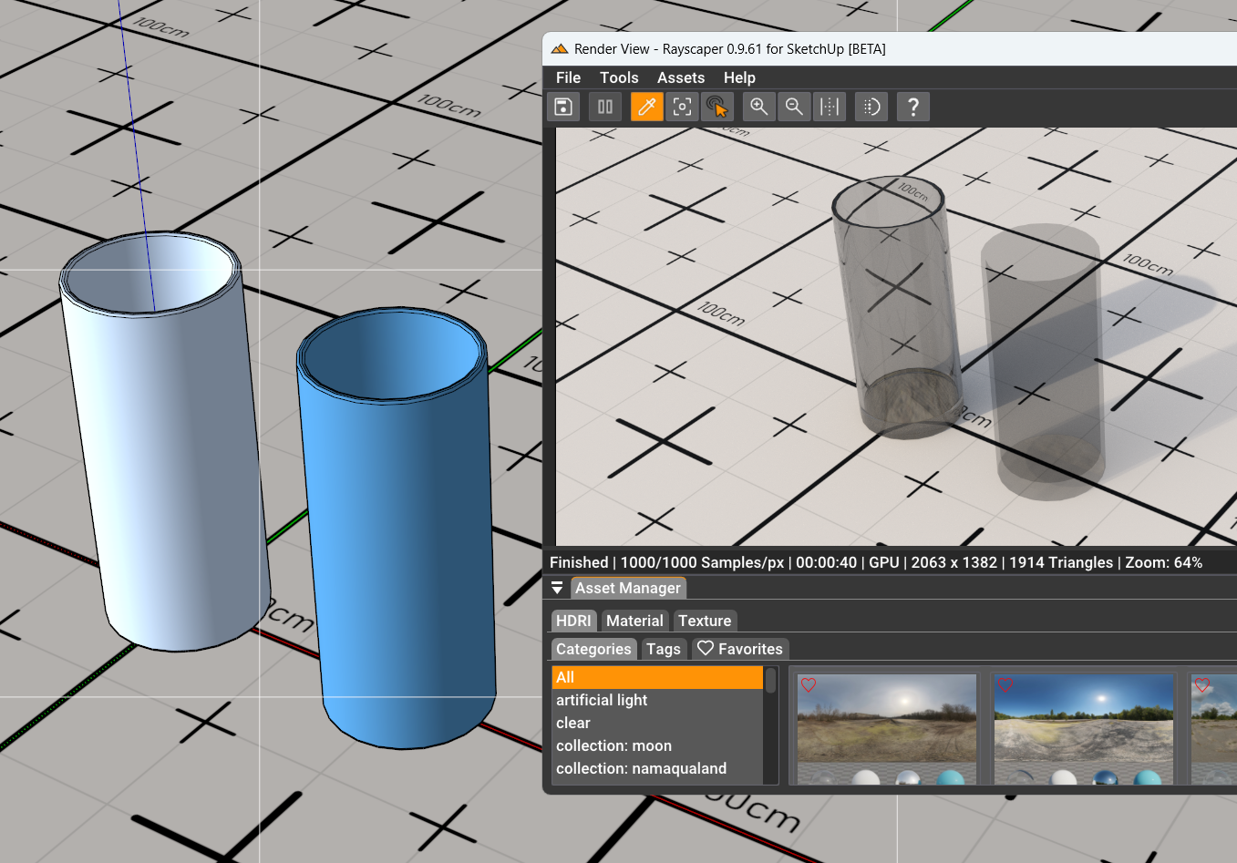

        You need to fix the glass materials. You have Thin checked I think which is only meant to be checked for planar surfaces.
        On curved surfaces it is causing issues because there is no refraction. Uncheck Thin. If the window glass and the glassware share the same material then use a separate material for the glassware Thin unchecked.

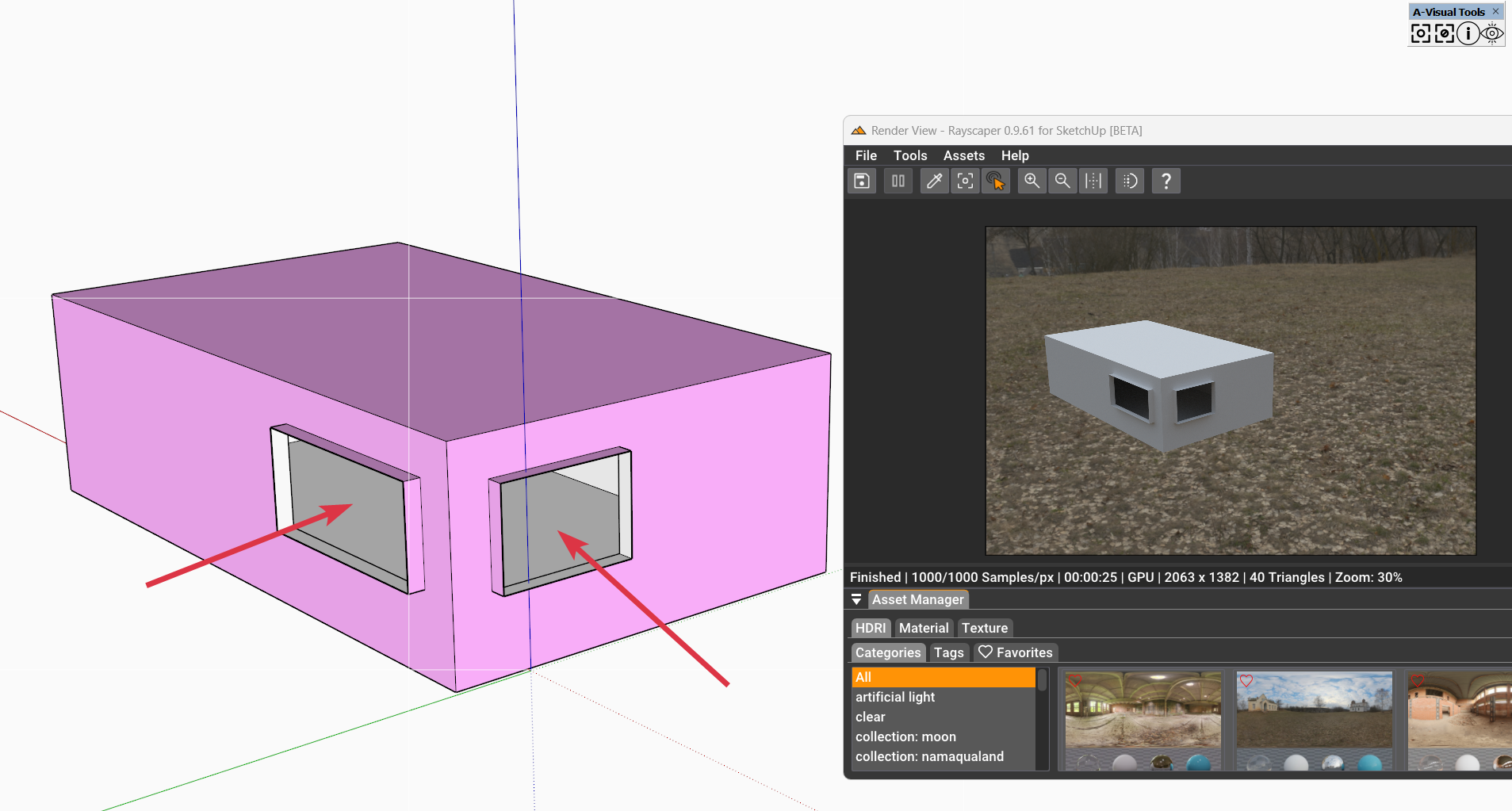

        I also think your model is probably completely enclosed with the only entry point for light being the windows. This means the opposite end of the kitchen is struggling and you can see that by the blotchiness on the island counter top, lower cabinets and the backsplash.
        Keep digging in things to understand why this happens. Its the best way to learn.
          This is what I mean by enclosed...
          The interior is really hard to bounce light around and in the real world there would be more internal light paths happening.

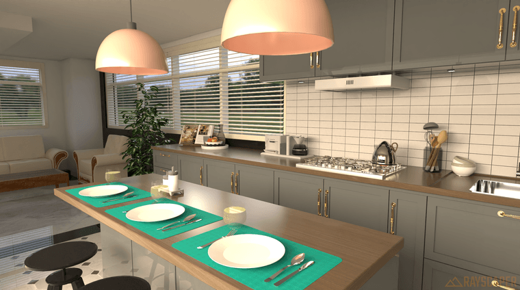

                OK, I have a habit of adding an emitter 'face' which infills any missing light and helps considerably.
                Dealing with a new health issues (Diabetes secondary to Crohn's) which is complicating life's already complex harmony.
                Sorry for my perfidity. 5 1000s 2081 x 1160  912945 tri 2m 01s GPU  Post pro increased exposure to 1.75.png Still need to adjust this.

                  I hope you are doing well. That scene already looks a lot better-lit.

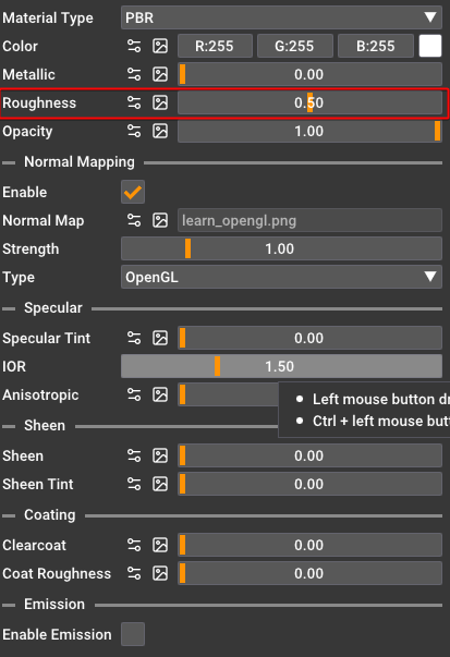

                  I'm not sure which material you are using, but you can control the roughness of the material:
                  Feel free to screenshot your material settings, which helps us understand your setup better.

                    @Mike-Amos said in Kitchen/breakfast bar:
                    One of the issues with reflection settings is, you cannot go lower than 0.
                    Roughness is a 0 to 1 slider.
                    • 0 = 0% roughness therefore 100% reflection (Black)
                    • 1 = 100% roughness therefore 0% reflection (White)
                    The values actually represent Black to White which is why when you plug greyscale roughness maps you create some very nice results.
                          • pixelcruncherP
                            Nice, the lighting is a lot better than the initial render. The glasses on the table are still missing some refraction.
                              Thanks, yes, the infill lighting I had forgotten is present and accounted for. Essentially a large low power light source (A simple face lit by colour emmission setting) which can be angled however I need to depending on where I want it to focus. 2 watts and 5k temp. Something I started using with Twilight. All of the original textures which failed have been replaced and work as advertised.
