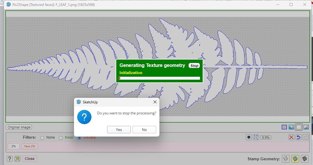

                          I was about to try this extension out - using SketchUp 2025 Pro, but the extension doesn’t seem to process the image. Image size 155x50 mm / 300 pixel/inch.
                          After 10 minutes still at Initialization…
                          Is there any guideline on max/ recommended picture size?
                          I tried it with a smaller resolution image, but I still can not get through Initialization....
                          Thank you

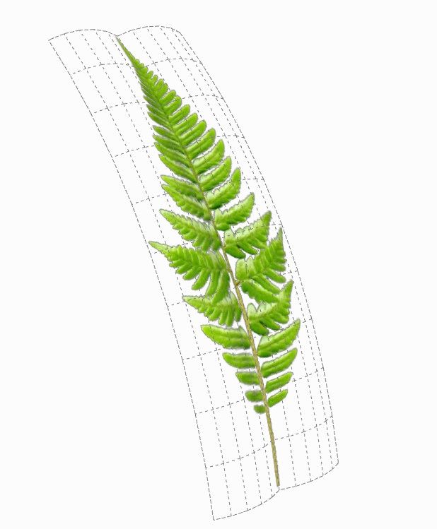

                          • kimgaK Offline
                            kimga
                            update: I succeeded with the plugin, when I opened the image in a new file.
                            The original image was on a bent plane. I suppose that was the problem…
                            R N 2 Replies Last reply Reply Quote 0

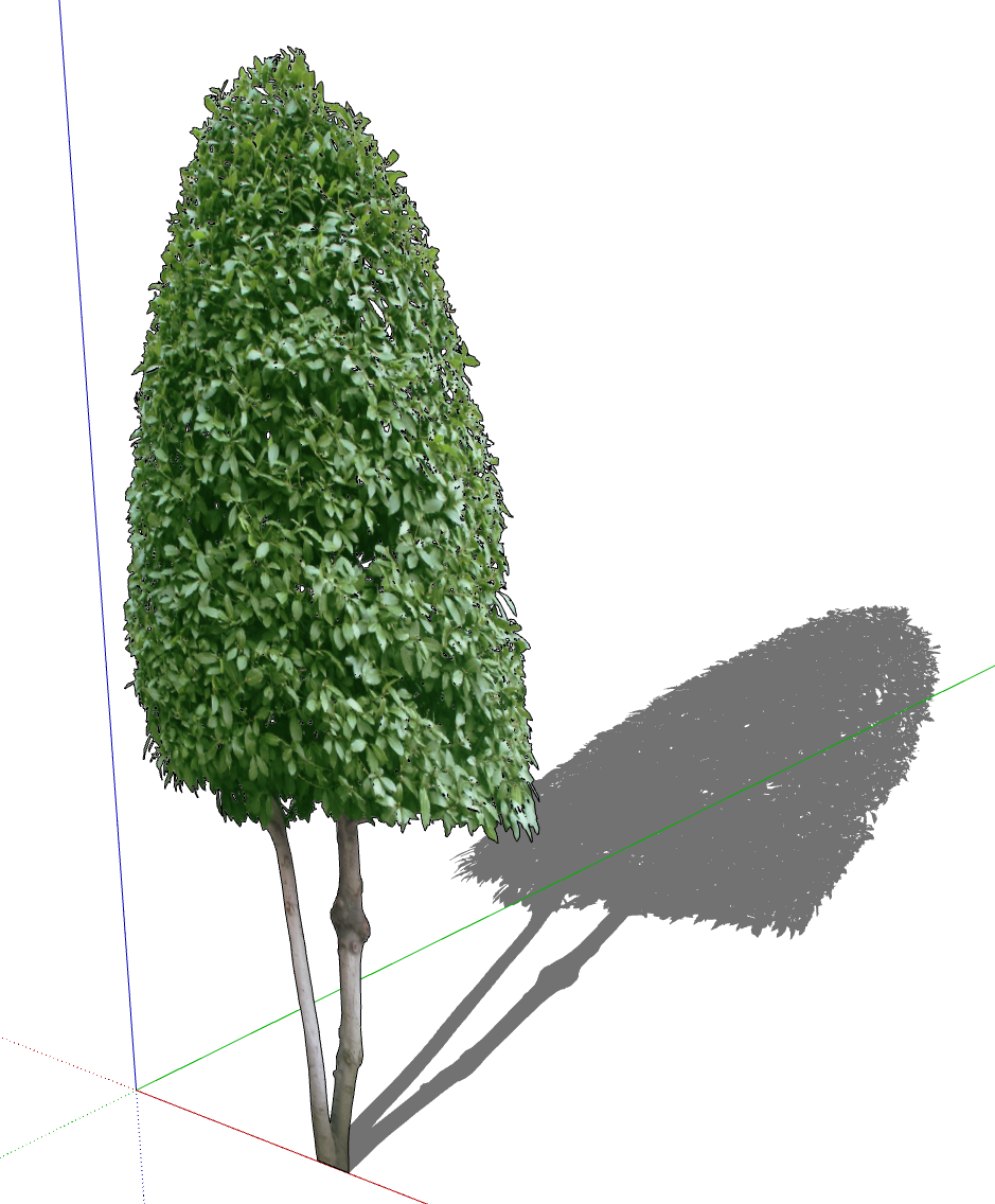

                            • R Offline
                              rv1974 @kimga
                              @kimga Are you going to to have trees with this amount of edges per leaf ) ?

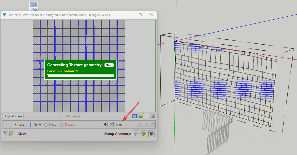

                              • N Offline
                                nasmrtcz @kimga
                                @kimga @TIG Hi. I also have this issue. It works really great in the picture, but after applying it on a textured face, it freezes like the leaf.
                                • fredo6F Offline
                                  fredo6
                                  Do you have the model for me to explore the issue.
