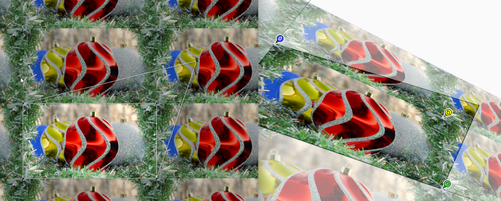

          @grizzler Yeah, it looks like SketchUp 2024 is kicking out the UV transforms when you execute the Make Unique command. Causing the image generated to be of no use.
          Looks what happens if you set texture to projected, sample it and then paint a face....
          As a workaround, you can export the face with the transformed UVs as an image and then bring that image in.

                                        I've tried taking the original photos on different devices, both apple and android (HEIC has to be turned off for Apple pics to be useable, but they still deform)
                                          Are you using the the Yellow pin to skew the image?
                                          That's UVW mapping which is not the same as your regular UV mapping which is purely 2D.
                                          If you skew an image in SketchUp you can introduce additional UV points so a plane with 4 verts could have 5 points when you view the UVs.
                                          Hopefully this shows what I mean. I think if this type of mapping is where the issue may lie.
                                          Either its the new engine thats flaky or the destination app does not support UVW mapping.
                                          I could be wrong.....it has happened before....many many times.
                                          grizzlerG 1 Reply Last reply Reply Quote 0

                                            grizzler @Rich O Brien
                                            @Rich-O-Brien said in Make Unique Texture giving weird results:
                                            I don't use the coloured pins, I used the non "fixed pins". I think I understand how the UV mapping might get messed up when I first make the adjustments, but once the image is in place I simply "Make texture unique" and that used to resolve the issue.
