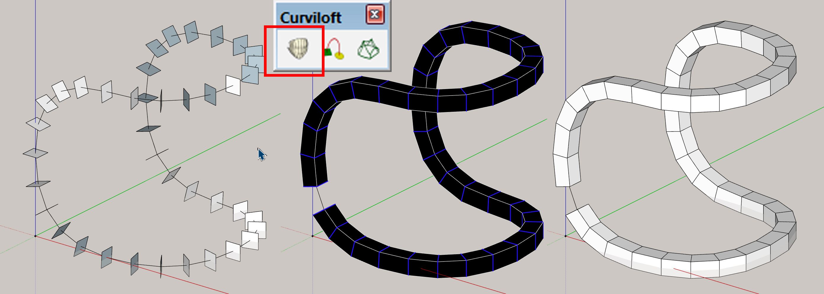

        @fredo6
        Now there is no longer the error that prevented us from moving forward but the result is wrong look at the result 2024 is deformed, it is not correct, while with 2022 the object is perfectly formed

            @fredo6
            For information I tried to insert the squares perpendicular to each node manually and then instead of using the follow me I used And as you can see the finished shape is correct so it is an axis problem at each node. Always with su 2024 and the library you updated

              @alexpacio2013
              Could you send me the model so that I investigate.

                @fredo6
                I have some good news to give you, with the new library it seems to work very well even with 2024. I hadn't restarted sketchup, which is why it wasn't working well. Now I've done some tests and everything seems to work correctly.

                  @alexpacio2013
                  Many thanks for your support. I prefer this, because I actually fixed a problem with a more robust algorithm. In SU2024, for whatever reason, the old method suffered from precision versus SU2022.
