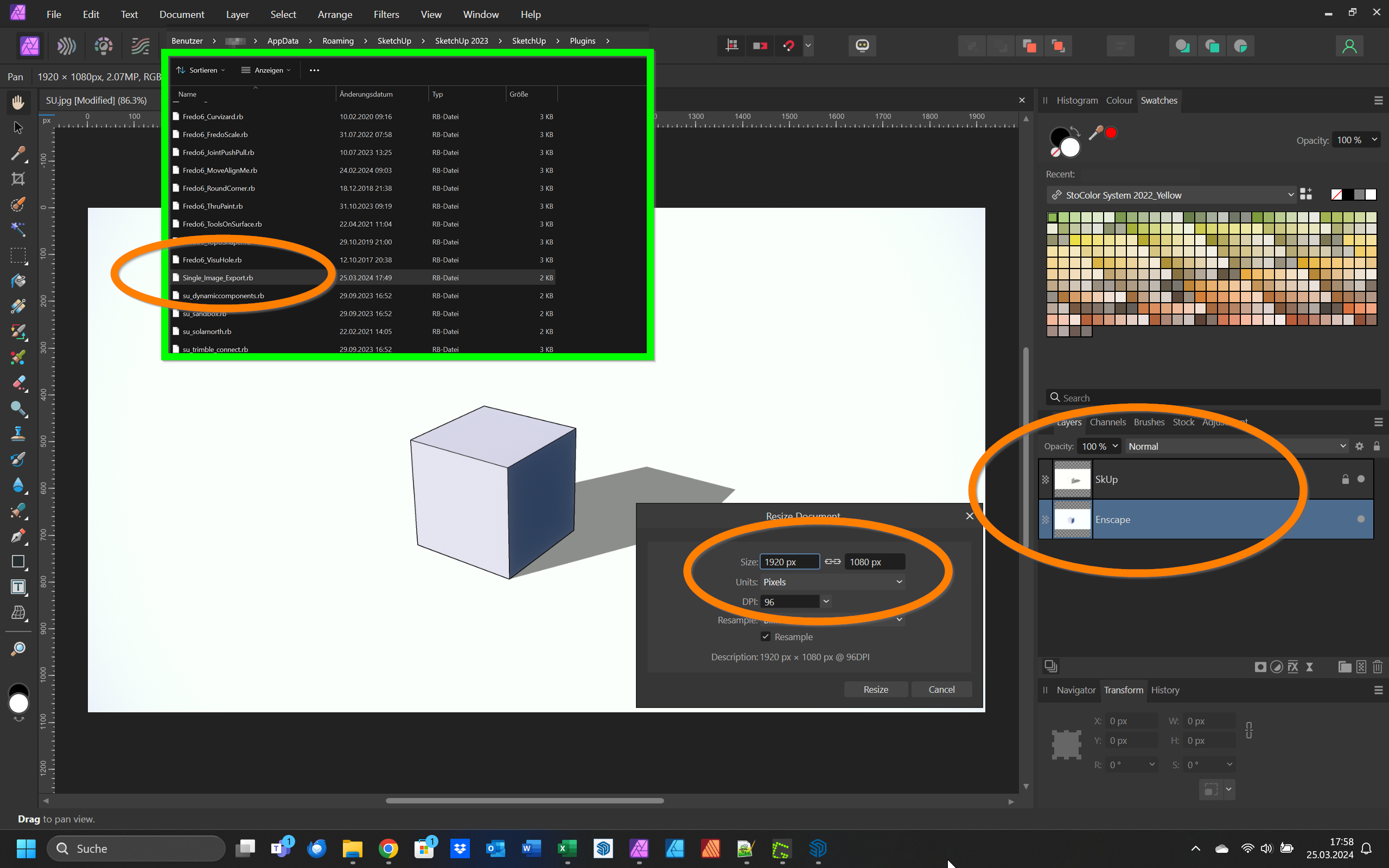

        If that helps: a plugin for easily exporting SketchUp images, as shown in the viewport but with free input of height, width, format and compression.
        Originally modified for a smooth scene animation to coincide with the Skindigo AnimationExport (Indigo Render Animation).
        Here reduced to a SketchUp single image output with input of image parameters.
        Transfer the code to an rb file called Single_Image_Export.rb and copy it to the plugin folder of the respective SUp version (tested up to SUp2022).
        Restart SketchUp ....

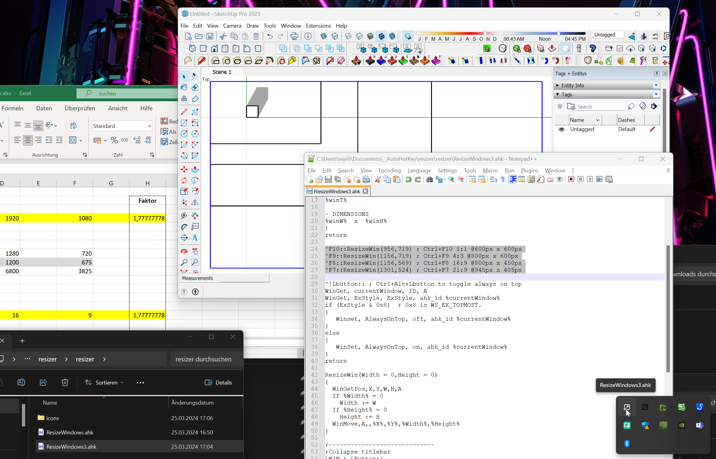

                Rich O Brien Moderator @HornOxx
                @HornOxx The reason I ask is because I use a AutoHotkey Window Resizer to resize SketchUp so the my viewport is a particular ratio. It takes a little bit of setup but saves me from guesswork.
                As an example if I hit CTRL+F10 it resizes SketchUp so its viewport is 600px x 600px. Now I can export 1:1 image ratio at whatever resolution I need.ShareX_XHP5wdLNgr.png
                Its a bit hacky but I've used it for years.

                      Rich O Brien Moderator @TIG
                      @TIG said
                      but Rich knows how, and perhaps he can share his example script, or point you/us to someone else's ?
                      To be clear, my AHK script, is cobbled together from other scripts and is dependent on a particular UI setup in SketchUp. This is a complete hack with a very blunt axe but it works for me.
                      • Windows only
                      • SketchUp 2023 (but you can customize for earlier releases)
                      • Single horizontal Toolbar stack
                      • Tray on but sized to narrowest width
                      NOTE: This works on any active window its not limited to SketchUp
                      Download and install AutoHotkey
                      Download and unzip this into a folder wherever you want on your system
                      πŸ”½ Resizer.zip
                      If you double click the ResizeWindows.ahk it will add an icon to your tray so you know when you have it active for use.
                      The shortcuts keys I've set are:
                      • Ctrl+F10 1:1 @600px x 600px
                      • Ctrl+F9 4:3 @800px x 600px
                      • Ctrl+F8 16:9 @800px x 450px
                      • Ctrl+F7 21:9 @945px x 405px
                      • Windows Key + LMB will hide the title bar of active window (Utility)
                      • Windows Key + RMB will show the title bar of active window (Utility)
                      • CTRL+ALT+LMB to toggle always on top (Utility)
                      • CTRL+SHIFT+F8 display a popup with the Width/Height of active window (Utility)
                      If you open the ResizeWindows.ahk with a text editor you will see the following:
                      #NoEnv
                      #SingleInstance, force
                      #Persistent
                      SendMode Input
                      SetWorkingDir %A_ScriptDir%
                      Menu, Tray, Icon, %A_WorkingDir%\icons\resize.png ,, 1 ; icon
                      #installKeybdHook
                      TrayTip, %A_ScriptName%, Started, 1
                      ^+F8:: ; Get window stats to create more presets below
                      WinGetActiveStats, winT, winW, winH, winX, winY
                      WinGetClass, class, A
                      MsgBox,
                      - TITLE
                      %winT%
                      - DIMENSIONS
                      %winW%  x  %winH%
                      return
                      ^F10::ResizeWin(956,719) ; Ctrl+F10 1:1 @600px x 600px
                      ^F9::ResizeWin(1156,719) ; Ctrl+F9 4:3 @800px x 600px
                      ^F8::ResizeWin(1156,569) ; Ctrl+F8 16:9 @800px x 450px
                      ^F7::ResizeWin(1301,524) ; Ctrl+F7 21:9 @945px x 405px
                      ^!Lbutton:: ; Ctrl+Alt+Lbutton to toggle always on top
                      WinGet, currentWindow, ID, A
                      WinGet, ExStyle, ExStyle, ahk_id %currentWindow%
                      if (ExStyle & 0x8)  ; 0x8 is WS_EX_TOPMOST.
                         Winset, AlwaysOnTop, off, ahk_id %currentWindow%
                      else
                         WinSet, AlwaysOnTop, on, ahk_id %currentWindow%
                      return
                      ResizeWin(Width = 0,Height = 0)
                        WinGetPos,X,Y,W,H,A
                        If %Width% = 0
                          Width := W
                        If %Height% = 0
                          Height := H
                        WinMove,A,,%X%,%Y%,%Width%,%Height%
                      ;Collapse titlebar
                      LWIN & LButton::
                      WinSet, Style, -0xC00000, A
                      return
                      ;Uncollapse titlebar
                      LWIN & RButton::
                      WinSet, Style, +0xC00000, A
                      return
                      Gui, +ToolWindow +AlwaysOnTop -SysMenu -Caption +Border
                      Gui, Color, cCCCCCC
                      SetTimer, Draw, 100
                      Draw:
                      MouseGetPos, MouseX, MouseY, MouseWin ; get mouse coords/window
                      WinActivate, %MouseWin%
                      WinGetActiveStats, Title, WinW, WinH, WinX, WinY ; get the stats of the active window
                      ; variables
                      DrawW := (WinW)
                      DrawH := (WinH)
                      DrawX := (WinX - 1)
                      DrawY := (WinY - 1)
                      ; show the gui
                      Gui, Show, NoActivate w%DrawW% h%DrawH% x%DrawX% y%DrawY%, Draw
                      WinSet, TransColor, CCCCCC, Draw
                      return
                      It is lines 24 to 27 that handle the resizing of the SketchUp window. These you may need to tweak to get the result you want. For me it does what I want. I could go into more details but look at this filthy hack length already.

                        I have installed everything, learnt that I need the older HotKey version 1 instead of 2, finally installed an editor with line display because of "...It is lines 24 to 27 that..." πŸ˜‰ and of course I immediately realised what potential lies in this systematic approach - wonderful!
                        (I originally hoped that this topic could still be dealt with via ruby - I can't do that either (LOL) but it still reads somehow more logically in my opinion)
                        And Rich, your script runs wonderfully, but of course doesn't lead to the desired result on the basis of my SkUp setup - but never mind, still great!πŸ‘
                        Now I have to get to grips with the script parameters and variables which take into account my typical SkUp setup whichcan be guessed by the screenshot below...
                            @HornOxx said in Julia Eneroth's Viewport Resizer / SketchUp 2023:
                            You can just press CTRL+F10 to set it to 'My Square' and then use File > Export >2D Graphic. In the option box if you click Use View Size you will see what the image dimension is for you.
                            Then adjust line 24 values accordingly to get you to 600px. Not the most elegant approach.
                            I think the better approach would be to ask Fredo if his Screenshot tool in Fredo Portrait could be extended to handle this. It already has ratio based selecting.
                            HornOxxH 1 Reply Last reply
                            • HornOxxH
                              HornOxx @Rich O Brien
                              ...Rich, I will definitely try your approach (first) to get a better understanding of what is going on between your script and the result "in front" since all that is pretty new to me and then continue by trying to tweak the script here and there to find out which are the right "lines" and values which are necessary - what an exciting thing and refreshing to learn always on top of that.
                              1000 times thanks for guiding me this far. And if Tig contributes from his almost inexhaustible fundus of knowledge, this is always and everywhere welcome in any case!!!!! ❀️
                              @Faust07
                              Hi and as always I am very happy to hear from You and when I look around in this fantastic group of people here I ask myself "where on earth did I go to school and was it worth it all these years" 😁 πŸ™„ πŸ˜€
                              Yor Script worked out of the Box and and delivered the result I need for my/our workflow.
                              I rendered a hiddenline (1920 x 1080) from SketchUp and did the same with the view synchronised Enscape, also in 1920 x 1080. Both graphic components fit together exactly. This means that I can also use the functional renderings from Enscape, such as Material-ID or Depth-mask etc. without any time-consuming fiddling in Photoshop and it also means that every other machine in my team reproduces exactly the same "picture"-result.
                              So, thank you too for dealing with my topic and for providing a working script on top of that! ❀️
                              (πŸ˜‚ Which schools did you all attend?)

                                      @Rich-O-Brien Hi sir. Really appreciate your help. Can I know how to get window stats to create more preset? I see in the script it state "+F8" and when I press those keys, nothing happen. Sorry Im a bit noob in this script-things.
                                        Rich O Brien Moderator @Firdaus_KL
                                        @Firdaus_KL said in Julia Eneroth's Viewport Resizer / SketchUp 2023:
                                        Windows Stats is to report the current dimensions of the active window. Pressing CTRL+SHIFT+F8 will open a dialog with the dimensions of the window.
                                        To create a new preset you would need to add a line with your preferred dimensions after line 27
                                        ^F6::ResizeWin(1301,524) ; Ctrl+F6
