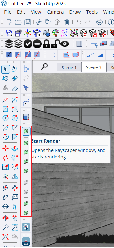

                                        And i no graphic card
                                        Can you check with the latest version I just released? Also check if that version brings the icons back. I think this has to do with your broken installation.
