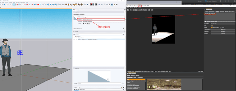

            • K Offline
              Krass
              thanks Pix, but no change for the lights component name with this version 9.64 If I rename the lights componant all lights go down
              Krass
              pixelcruncherP 1 Reply Last reply Reply Quote 0
              • pixelcruncherP Offline
                @Krass, just as a sanity check, you are not changing the name right, and not the component definition name?
                • K Offline
                  Krass
                  ok, sorry, Indeed, I changed the component name and the instance name... thanks. Perfect, I'll test it.
                  However, I don't understand. I set the HDR definition to 8k, and it seems that it doesn't take this definition into account. I'll redo the rendering after downloading the map from the site.
                  Krass
                  pixelcruncherP 1 Reply Last reply Reply Quote 1

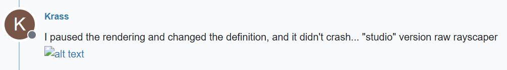

                              • K Offline
                                Krass
                                Here's a version with an HDRI map background
                                But I'm trying to make a "studio" render for a friend, and Sketchup crashes when I change the image resolution during rendering. I set it to 300x400 and double-scaled it twice, and it crashed both times. Should I send a crash report?
                                https://jskup.fr/wp-content/uploads/2025/09/rocking-chair-3-Phil94.jpg
                                Krass
                                • K Offline
                                  Krass
                                  I paused the rendering and changed the definition, and it didn't crash... "studio" version raw rayscaper
                                  alt text
                                  Krass
                                    @Krass said in Rayscaper New Releases:
                                    Making sure I understood you correctly. Just changing the resolution (of the rendered image) in Rayscaper made the software crash?
                                    alt text
                                    Nice render, it doesn't seem to have the correct tags in the forum post because the picture is not visible for me immediately.
