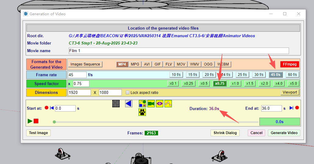

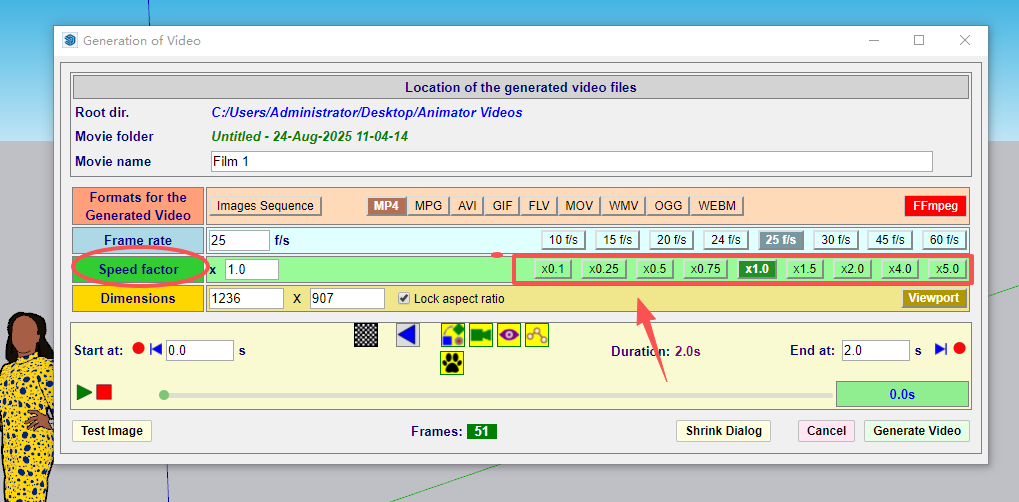

                          Please see above image. for previous verisons (before v4.4) for example if you choose 0.75 (frame tate I choose 45f/s I don't know if it affects the speed), and if your video last 100 seconds, then the video generated will be 133seconds, that mean 100/133=0.75 (this is exactly the factor you choose).
                          however after I install v4.4 version, and choose the 0.75 factor, the generated video will last 241seconds, and even I input 0.95 factor, the video last 170seconds around. I think maybe there is something you can adjust in your program. to make the speed factor back to normal.

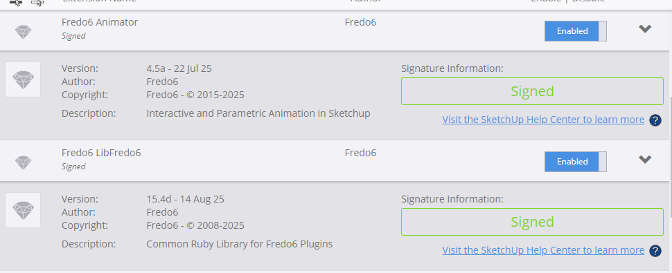

                                you can see my version now is v4.5a
                                I just created one 36 seconds video and choose 0.75 with 45p/s I finally get 1 minute and 26second video:

                                            I find timer's possible reason. when I use the computer with old CPU (I7 4790), the video's time will be slow when you set 0.75 factor. however when I use the computer with relative new version CPU, the time will be normal.
