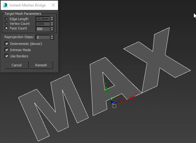

                        One suggestion.. Can you make option maybe in the next reliese.. "Stick with orriginal contours" for triangulated mesh.. So the plugin would not make triangles between not adjacent contour lines (for example one point of triangle on hight=2m another h=3m and third h=5m). Could be done by inforcing engine to require for points two the same hights and fird different.. simple check.. I'm crab with programming but could be nice add on.. I usually have to stick with orriginal contours...
                          rv1974
                          http://www.scriptspot.com/files/u1362/remesh.gif
                          http://www.scriptspot.com/3ds-max/scripts/instant-meshes-bridge
                          Fredo, could Toposhaper follow the contours as shown on attached gif?
                          And, generally speaking, is doable to make a bridge to this external free retopologizer?
                          (https://github.com/wjakob/instant-meshes)
                          Or make something similar but independent πŸ˜‰ ?
                            Well. I know how to constrain the triangulation to the contours. Simply, that's not a trivial development and it requires some time. But it should come.
