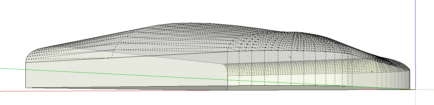

                    Here's my suggestion using Artisan (or Sub Divide and Smooth)
                    [flash=800,600:dy6uok5o]http://www.youtube.com/v/ckwgXqKH_uc[/flash:dy6uok5o]

                        Here's my shot at it.
                        computer bottom.skp

                          I was surprised at the final result as I was thinking Curviloft and BezierSpline. Then SDS came to mind. It's a plugin that is so powerful that it never fails to impress me.
                          All I need now is talent πŸ˜’
                            Rich, that works quite nicely. Good job.
                              Don't thank me. Thank Dale. It's his b'day today as well so I'm sure he'll appreciate it!

                                yet another suggestion here.. πŸ˜„
                                using the loft tool in curviloft set to 'bezier method2 respect tangency' along with the uniform B-splines from bezierSpline.rb..
                                results from the video
                                [flash=700,555:ek1lph60]http://www.youtube.com/v/Xt_MffSkCEI?version=3&hl=en_US&rel=0[/flash:ek1lph60]
                                dotdotdot
                                  Jeff, that's very good. I agree the corners probably aren't circular curves. I just used them for speed but would have used a Bezier curve instead. I did use a Bezier curve for the profiles, though. I used TIG's Extrude Edges by Rails and it went pretty quickly. I did three sides since all three have different widths.

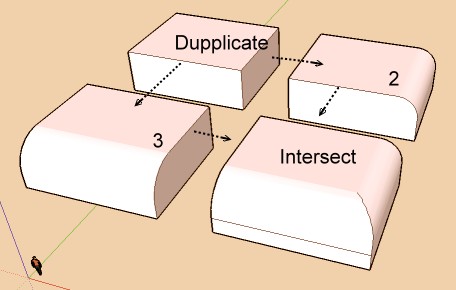

                                    Mmmhhh I'm a bit late but here's how I've solved this in the past
                                    bevels.skp
                                          [attachment=1:299w5w9d]<!-- ia1 -->bevels.skp<!-- ia1 -->[/attachment:299w5w9d]
                                          [attachment=0:299w5w9d]<!-- ia0 -->bevel.jpg<!-- ia0 -->[/attachment:299w5w9d]

                                          May I ask what tools you have used to do this? πŸ˜„
                                          • K Offline
                                            KarinaGM
                                            It is explained in the file I attached, but for the curves I used bezier spline, restricted to 8 segments per curve (the default is 20).
                                            Push pull for the profiles and curviloft to join the resultants edges (the image attached to the message).
