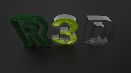

                                        Rico91
                                        http://lh3.ggpht.com/_rMc47FEl0fA/S-1CLDIV09I/AAAAAAAAB_M/VbdjAQArNwY/untitled.56.jpg
