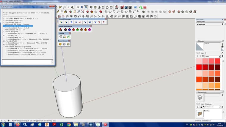

                                          Bublifuk21 @fredo6
                                          Here is what is in ruby console. I dont know why is this not loaded. May be this is the problem. But how can I fix it? - LibFredo6 E6 Binary NOT loaded
