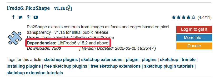

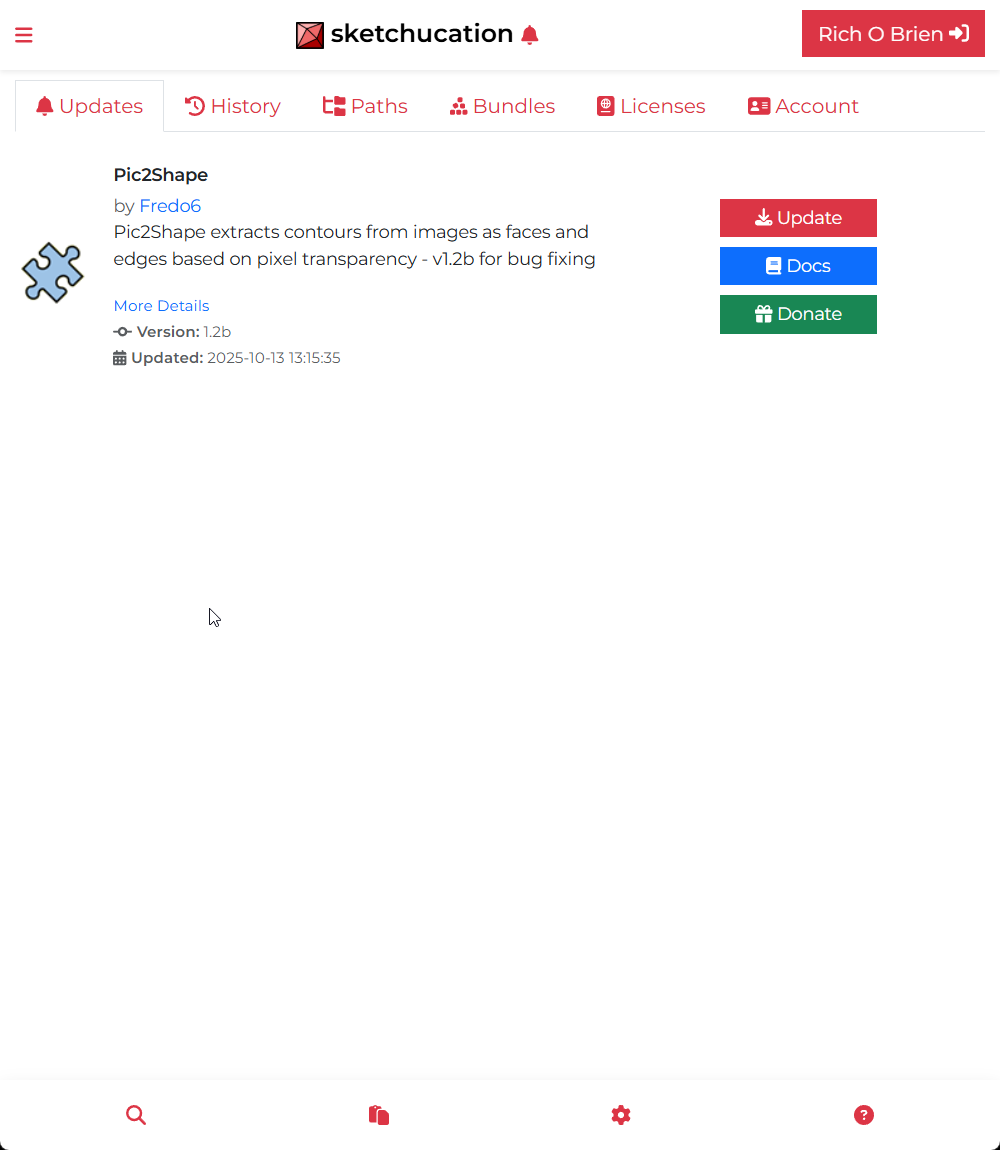

  • RE: SCFLicense: Extension Licensing on Sketchucation
    Are you using the latest version of both Curviloft and Libfredo?
    That may be the reason you are prompted. Otherwise you may have simply forgotten you installed at some point.

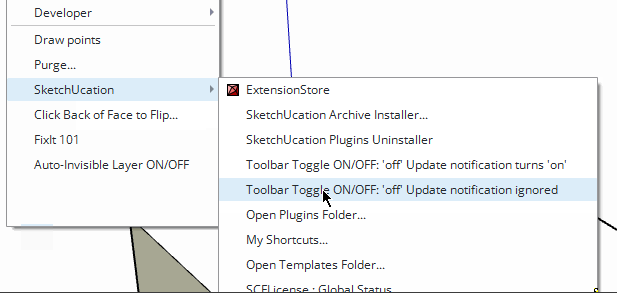

    @comlife7 said:
    rbz파일을 인스톨해도 아이콘이 생기지 않음. 툴바에도 없음 스케치업 v2022사용중. 정품 사용자이고 라이센스도 가지고 있음
    No icon appears after installing the .rbz file, and it doesn't show up on the toolbar either. I am using SketchUp v2022. I am a legitimate user and hold a valid license.
    Which exact extension are you referring to ?
    If it's a Fredo6 extension, then look under the Tools menu.
    Remember that you need LibFredo6 installed as well - because this supports Fredoo6's extensions.
    And you need the latest version of the SketchUcation tools installed, as that manages the licenses.
