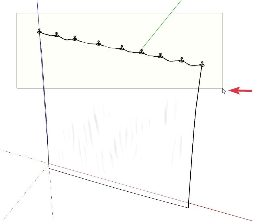

RE: FredoSection partly not working
It works so it might be how you are expecting it to work.
Maybe shared a simple model where it is failing for you.
