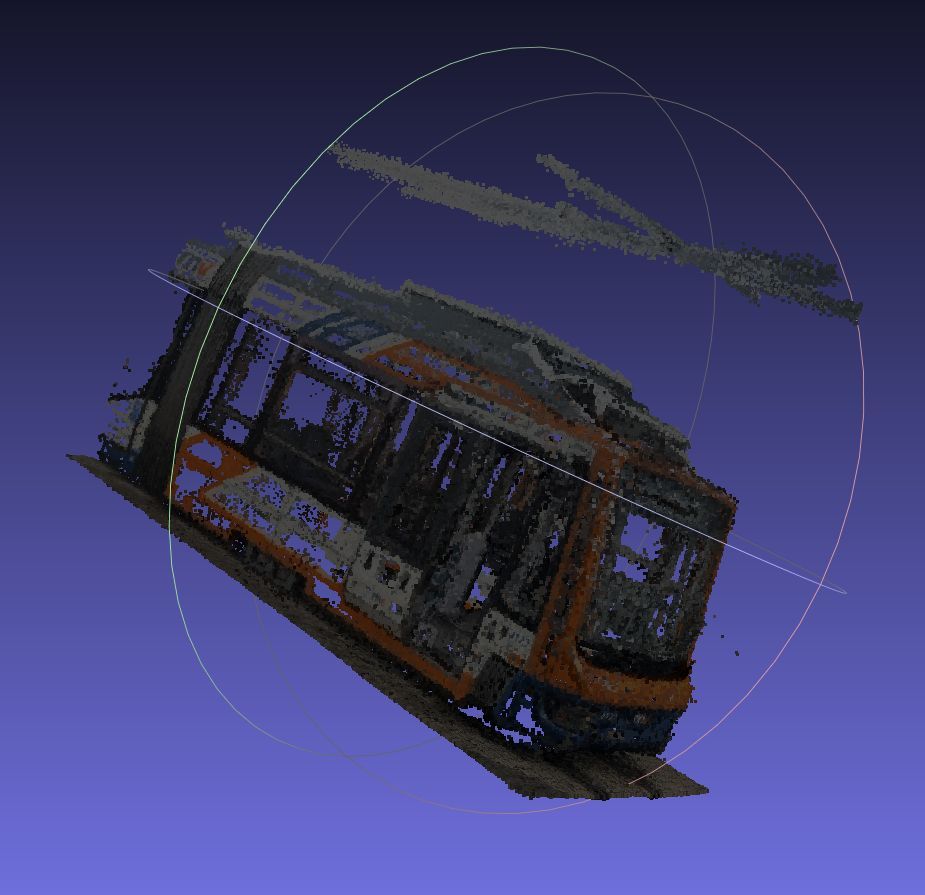

          OK, got that app but the file is reported as having no splat contained. Talking about the tramway model.
            The PLY file is a point cloud not a 3DGS gaussian splat.
            If this was a true gaussian splat file it would be much larger than 7.1mb
              Meshlab which I had forgot I had.
                Yep, that point cloud had colour data applied to points.
                  I guess Joke has his answer either way.
                  • jo-keJ
                    jo-ke
                    importing to meshlab works for me as well, but the import to sktechup makes a crash.
