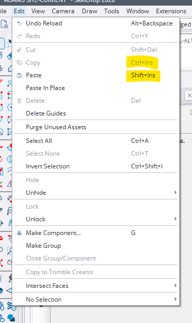

                    My second day of using 2026 and I've been having issues with copy and paste working inconsistently (I use Ctrl+C, Ctrl+V- just like every other windows program) Just noticed that sketchup 2026 edit menu shows the shortcuts for these as Ctrl+Ins, Shift+Ins. Presumably this is related to the insconsistent behavior I am experiencing when using the old/ standard shortcuts. Makes total sense to use a shortcut with keys on the opposite side of the keyboard... thanks Sketchup.... unreal.
                      CTRL+C and V works for me even though menu shortcut shows INS
                      I'd say 2026.1 or 2 will address the issues.
                      If you check the shortcuts you'll see 2 entries
                          On PCs in v2026.1 some nitwit swapped the order in the Preferences >Shortcuts listed for the Edit commands for Copy Ctrl+C and Ctrl+Insert, and also the Cut [+X/+Insert] and Paste [+V/+Insert] etc, so the Edit menu now gives you an illogical listing because the long established ones now come second and so they aren't listed in that menu.
                          They still work, Unfortunately they are hardwired and not editable in Preferences>Shortcuts.
                          Hopefully common sense will revert this weirdness in the next update.
