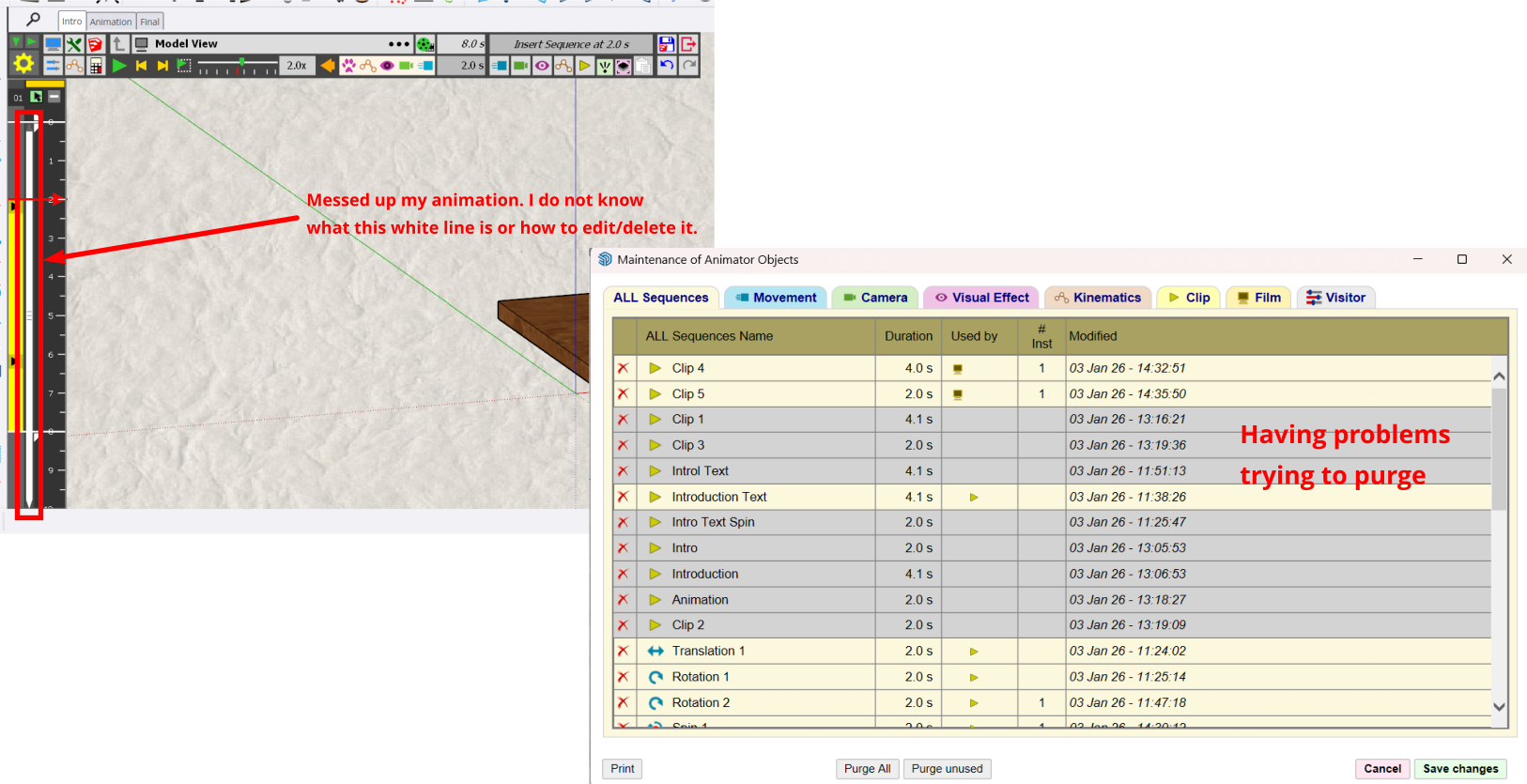

                                I am having more problems toady. The image below will show 2 problems I am having that I need some help with. The first problem is that I have something that got added to my animation that I do not know what it is and cannot find a way to delete it. The second problem is that I cannot purge items (like unused clips and segments).

                                        • Rich O BrienR Online
                                          I merged that extra thread to here. Creating separate threads pointing to other threads is not helping you.
                                          As you have proven, many times already, that if you persevere when you encounter issues you'll figure it out.
                                          That bar you are pointing is a scrollbar. Not an element related to the animation. You have Clips starting at 24secs in your timeline than go to 33secs.
                                          Regarding your issue Purging. You haven't explained the issue so I can only guess.
                                          If you click Purge Unused then Animator will indicate, in Pink, all the unused elements in your file. Then if you click Save Changes and Exit Tool it will remove the Unused Elements.
                                          It will not remove elements while you still have the tool active.
                                          Lots of these issues you encounter are resolved by A/B testing yourself. If it is not doing what you expect then try a different approach to understand how it is expected to work.
                                          So here's a task for you. Get the clips that are way down the timeline to be at the start.
                                          See if you can find a way to do it without having to drag the elements individual.
                                          HINT: Right click on your timeline.
                                          • ntxdaveN Offline

                                            @Rich-O-Brien said in Scene animation with Animator:
                                            Thanks Rich - I honestly thought it was a mistake to add another thread. I guess it shows that I needed/wanted more feedback.
                                            Thanks again. Yes, even though I have gotten kind of frustrated at time, if I do enough research (especially after some of your responses) I have usually found a solution.
                                            I do not know why I did not see/realize that is what it was. DUH!
                                            Thanks again. I just was not taking the correct steps. I have been able to purge the unwanted stuff and am redoing other items. I had watched one of Fredo6's videos and thought I was taking the right steps. You explanation got the issues resolved for me. I have been able to clean up the info now. It also lead me to going in and changing the names of several segments and clips so now I can look at the list and see what is what.
                                            Done..........another silly error on my part that was partly the result the silly bar that was showing up.
