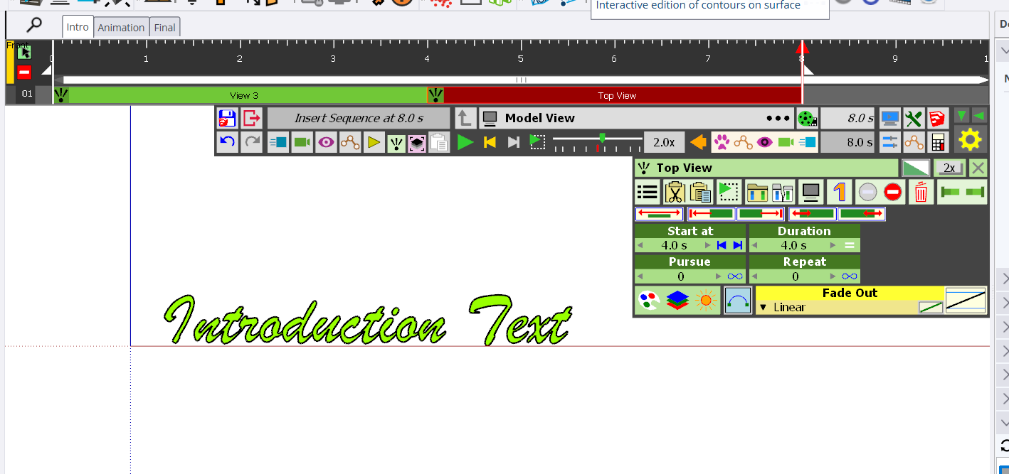

      It has been a while since I used Animator to create an animation. In particular, I want to build an animation with the following features:
      • A “start screen” that includes some text that I may/may not want to scroll or fade in or out
      • I would like to show/hide some items in the model that are/can be controlled by tags
      • I have several scenes in the model that I would like to use to control the visibility of the model (camera and visibility of some objects)

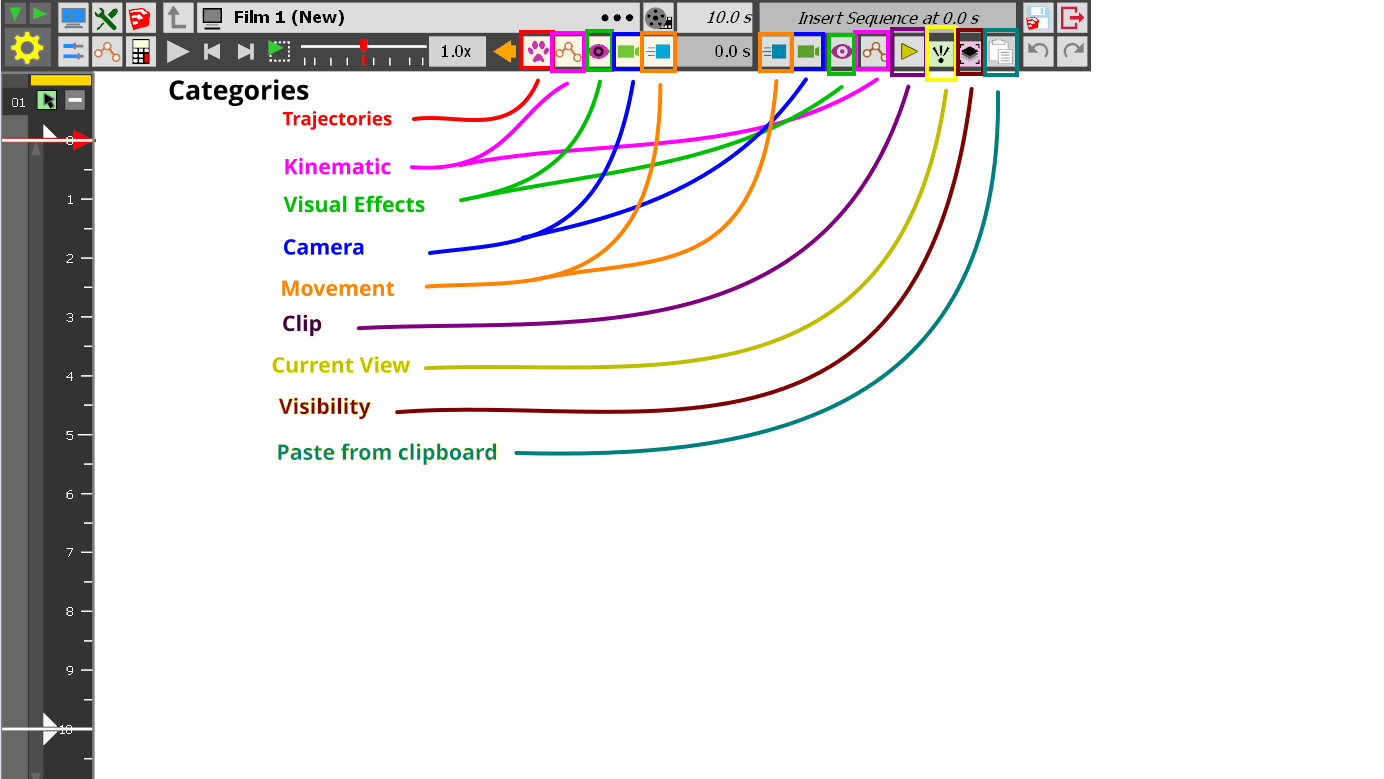

              Animator requires the user to put in the hours playing around with it. Its also pretty advanced and requires a user to be proficient in SketchUp to begin with.
              Anyone adept using Animator has put in the time to discover its features.
              You need to set your Camera to use a scene.

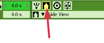

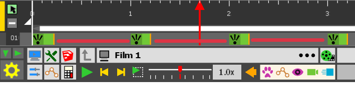

                OK @rich-o-brien, I just launched SU and then started Animator. How did you get to the option in your post?
                  Rich O Brien Moderator @ntxdave
                  @ntxdave said in Scene animation with Animator:
                  Double clip a strip in your timeline to edit that strip's properties.
                  ntxdaveN 1 Reply Last reply

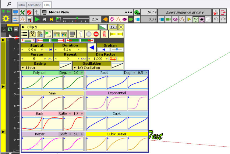

                  • fredo6F
                    Scenes can be used in Animator for their camera. The interest versus setting the camera in Animator is that Animator will use the camera of the scene , which is controlled outside of Animator.
                    However, for tags (layers) and visibility of objects, you need to use Visual Effects.

                        @fredo6 said in Scene animation with Animator:
                        If you look at the tutorial I referenced above at about 1:49, you will see a very interesting way the poster handled an object (trvealing in it I circular pattern).. I want to do something similar with some intro text (probably reveal it in a left to right pattern - like writing or printing the text.
                        I have some other things in the back of my mind but I need to takes one step at a time. Bottom line is that I think Animator is a great tool but learning how to take advantage of its features is somewhat difficult.

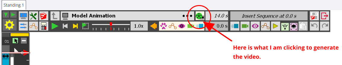

                                    OK, still more progress but when I click on the Generate Video link, nothing is happening.
                                      Go to Tools > Fredo Collection > Animator > Video... menu for guides
                                      • ntxdaveN
                                        ntxdave

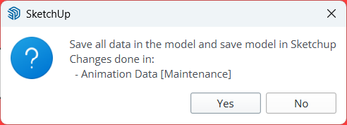

                                        Yes, I went there but I cannot generate a video. Again, when I click on the Generate Video button in Animator, nothing happens. It does not launch the screen for me to select the options and generate a video.
                                        • fredo6F
                                          Can you open the Ruby console.
                                          • ntxdaveN
                                            ntxdave
                                            Here is what I see:
                                            BTW: Here is what I am clicking to generate the video.
