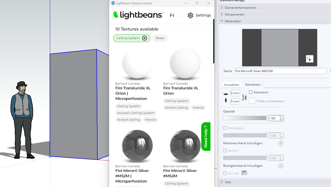

                        I just download from warehouse, take a mirror, but cannot use the metal or roughness. I tried some more materials - ceramic, plastic, roof - all the same. Use 2025 Pro. ๐Ÿ˜ž

                          Fuchur Newcomers
                          I find this in an other part "Make sure you are using the new graphics engine. Check in Preferences>Graphics. If youโ€™re using the classic graphics engine the PBR option wonโ€™t be available." - Now I can us it. In past I habe trouble with SKP and the helpline said I need to change on "old graphic"
