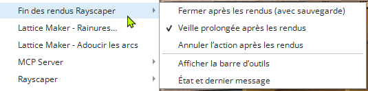

                                            SHUT DOWN COMPUTER AFTER RAYSCAPER SCENES RENDER
                                            I’m not sure if something like this already exists, but I asked ChatGPT to create an extension for me that puts the PC into hibernation after Rayscaper finishes rendering scenes.
                                            The first button closes SketchUp once the renders are complete; the second one shuts down the PC—or rather, puts it into hibernation—after the rendering is done.
                                            I’ve only tested it with small-scale renders involving about ten scenes, and it works well. It allows me to run longer rendering tasks overnight or after I’ve left for the day.
                                            I’ve attached the RBZ file (it’s currently in French, but once it’s gone through beta testing, we can create an English version!). Works well on my SU 2024.
                                            If you’re able to test the extension to see how well it works, thanks in advance!
                                            Shut down PC after Rayscaper scene render.rbz
                                            But it is in french :
                                            Krass
