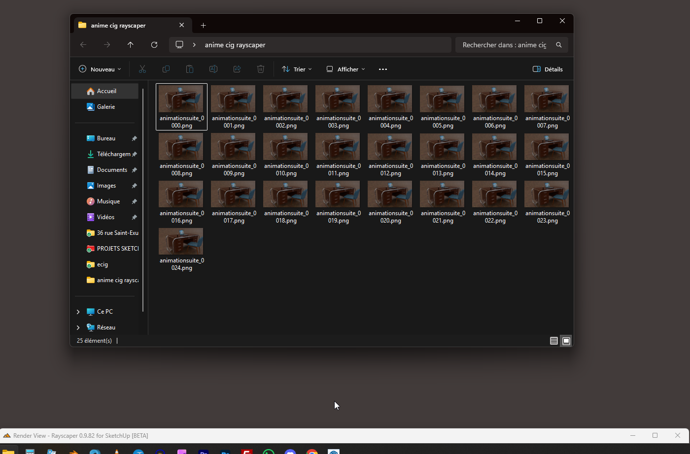

                              • KrassK
                                Krass
                                Too bad, my first animation attempt crashes after three frames... yet the functions, animation settings, and interface are very well done.
                                As soon as I minimize the window to show the desktop, it crashes.
                                • KrassK
                                  Krass
                                  By dragging the Rayscaper window to the bottom of the screen, it seems to be holding... I'll let you know in about an hour and a half.
                                  • pixelcruncherP
                                    @Krass Sorry about that, it's a brand new feature (implemented two weeks ago), so rough around the edges. It would be great if you could also send the logs for this crash?
                                    Pro tip, first render out a small resolution, low samples per pixel animation. They you get an immediate feel for it without having to wait too long πŸ˜‰
                                    • KrassK
                                      Krass
                                      yes I'm now rendering with default SPP, anyway this new feature is such I giant step, i'm so exited...

                                          • KrassK
                                            Krass
                                            My first animation with Rayscaper!
                                            Comparatif rayscaper/magnific upscale – jskup
                                            https://jskup.fr/wp-content/uploads/2025/12/animationsuite_0000_1.mp4 Avant Après
