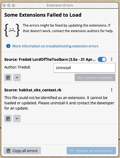

Anyway, the trouble might be in the habitat_site_context.rb script, as shown in the Sketchup startup error box..
Did you get an error with the previous version of LOTT and this script installed?
