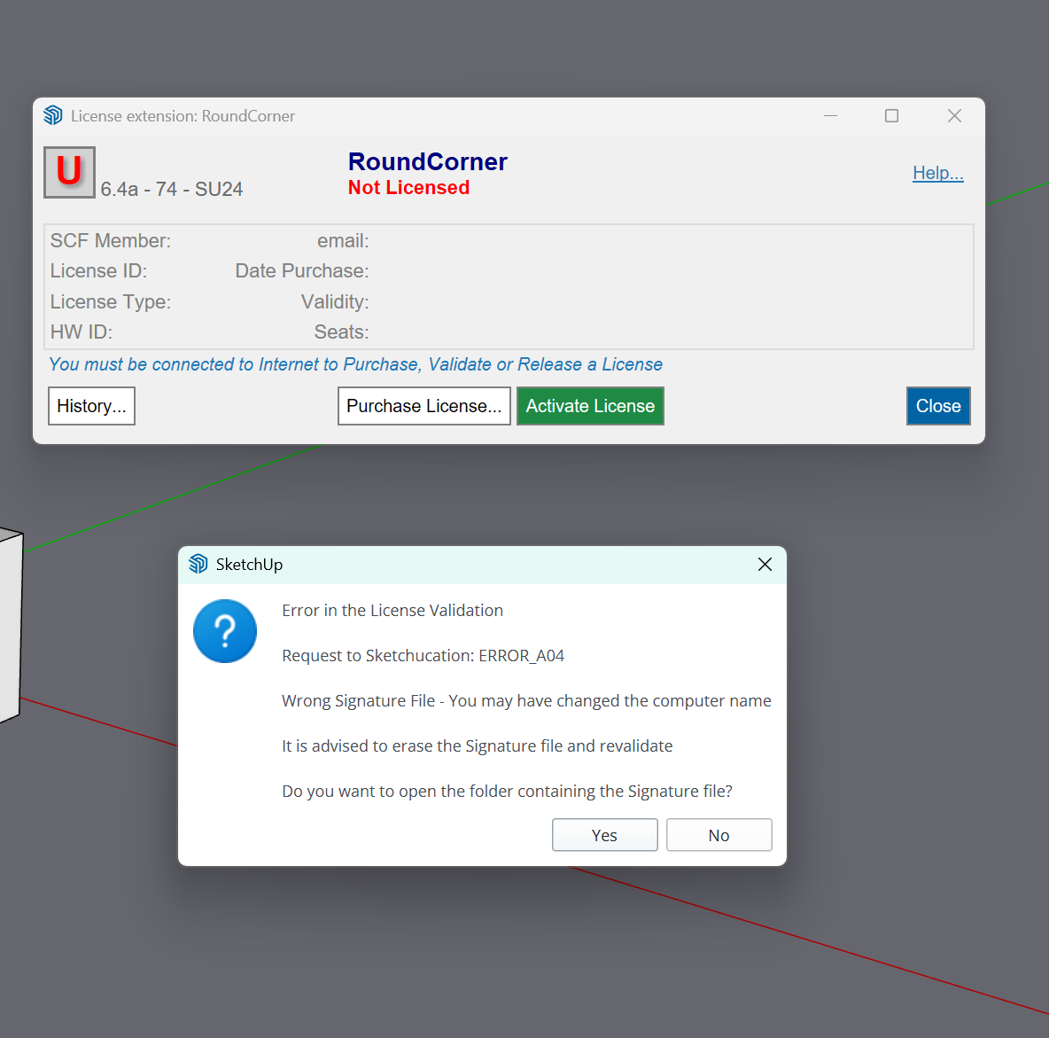

            Hello, I would like to ask for advice on how to activate the license for the purchased RoundCorner Perpetual License plugin. Unfortunately, I had to reinstall Windows, and when I tried to activate the purchased plugin again, I received the following error message (see screenshot).
            Thank you very much for your help.

              • Rich O BrienR Online
                Does your device name use non-alphanumeric characters like é áó ú ?
                If so rename your device using only alphanumeric characters.
                Go to C:\Users\SomeName\AppData\Local\SCF Licenses and delete the signature file
                Open SketchUp and activate license.

                • L Offline
                  LukasP @Rich O Brien
                  @Rich-O-Brien
                  Thank you very much for your quick reply. The advice was helpful. Thank you very much and have a nice day

                          • N Offline
                            Noddi17
                            Hello,
                            I'm experiencing an issue when trying to validate the license for the RoundCorner plugin in SketchUp.
                            Each time I try to activate the license, I receive the following error:
                            "Error in the License Validation
                            Request to Sketchucation: ERROR_A04
                            Wrong Signature File - You may have changed the computer name
                            It is advised to erase the Signature file and revalidate"
                            To resolve this, I have already tried the following:
                            • Deleted the signature file from the SCFlicensing folder
                            • Changed my computer name to English and restarted
                            • Reinstalled SketchUp
                            • Made sure my internet connection is stable
                            Despite all these attempts, I still receive the same error, and the plugin does not activate.
                            Could you please help me fix this issue?
                            Thank you in advance for your support.
                            TIGT 1 Reply Last reply Reply Quote 1
                              Please run the Window > Libfredo Settings > Fredo6 Plugins Information for Sketchucation Support menu command in SketchUp and copy/paste the output into your reply.

                                    • G Offline
                                      Gábor
                                      @unterluggauer Have you recently changed your computer name? If yes, there are 2 possible solutions:
                                      1. Change it back to the previous one or
                                      2. Erase your signature file at C:\Users\username\AppData\Local\SCF Licenses\SCFLicenseSignature - DO NOT MODIFY OR DELETE.txt
                                      • M Offline
                                        Mesak4719
                                        It appears error_a04
                                        • G Offline
                                          Gábor
                                          @Mesak4719 Have you recently changed your computer name? If yes, there are 2 possible solutions:
                                            And if you erase that file you will need to re-validate the licenses...
