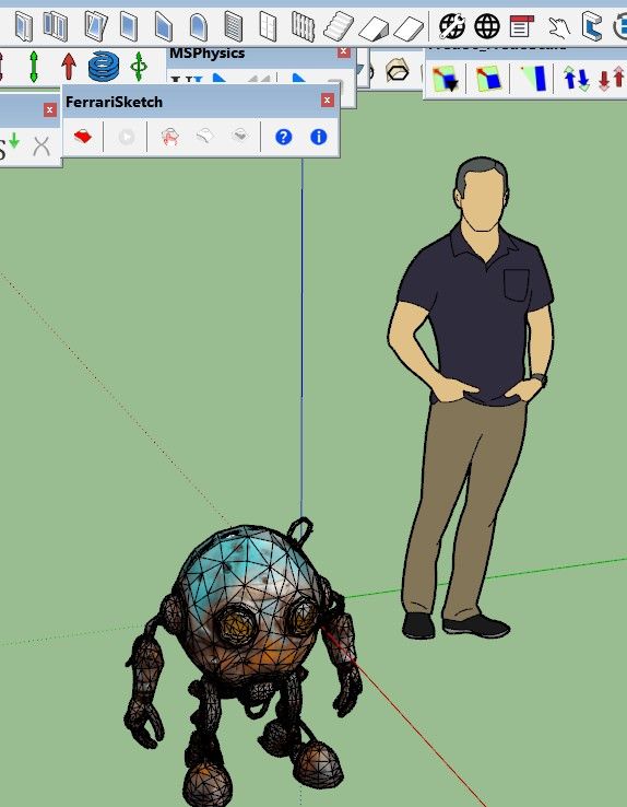

      @samuel_t
      Med resolution (who don't works)
      https://moiscript.weebly.com/uploads/3/9/3/8/3938813/tripo_convert_a8a4796d-366a-45ec-b815-09b229a99bbd__2_.fbx
      Low resolution who works
      https://moiscript.weebly.com/uploads/3/9/3/8/3938813/tripo_convert_c35581b0-d804-4224-990b-b31022f0afd8.fbx
      Maybe the textures...
      https://moiscript.weebly.com/uploads/3/9/3/8/3938813/uir-source.fbx
      But maybe sure on my latop 12 years old there is only 8G Hard Memory! 🙂

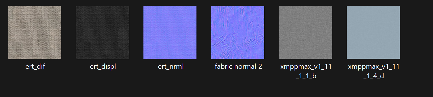

                  • A
                    artemisglt
                    hello! and thank you for the great plug in! I am trying to import an obj file of this bed in sketchup.
                    link text
                    I select the option to claim missing textures and select the obj file. In which order do I select the textures?
                    The model has a diffuse map, two normal maps and a displacement map. If I select the diffuse map and the two normal maps, I get an error..
                    Any ideas?
                    panixiaP 1 Reply Last reply
                    • panixiaP
                      panixia @artemisglt
                      @artemisglt You just select the diffuse map and call it a day.
                      (you can add the other maps after the import if you really need them)

                      • A
                        artemisglt @panixia
                        @panixia if i press claim missing textures, then import the obj object, I select the diffuse map and then it asks me to select again another missing texture. if i click the normal map, it asks me for a third texture and if select all three I receive an error. if i select the diffuse map every time again I receive an error.. any ideas?
                        • panixiaP
                          panixia @artemisglt
                          @artemisglt does it happen with a specific model or with all models?
                          A 1 Reply Last reply
                          • A
                            artemisglt @panixia
                            @panixia it happens with all the models, that is why I asked to see what I am doing wrong. I send the link to the initial model, I referred to, if you can have a look.

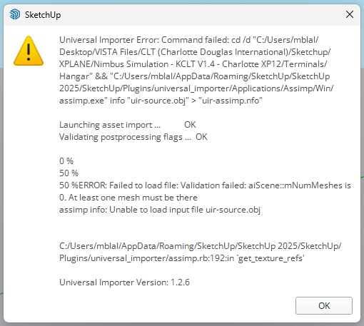

                            • M
                              mblally Newcomers
                              Hello, thank you for the community plugin, but I'm getting this error message when I try to import. It looks like you had someone else with a similar error about a year ago. Any solution?
                              samuel_tS 1 Reply Last reply
                              • samuel_tS
                                samuel_t @mblally
                                @mblally Hello. You're welcome! This issue will be fixed in the next plugin version.
