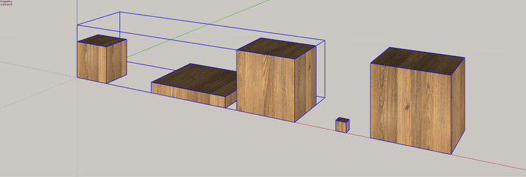

TT
I created 2 groups
1-solids
2-non solidRt click on either shows your menu grey'd out
here is the file
dtr
Yes? Everything is working exactly as expected. None of the groups are scaled, so there is no way it can scale the definition.
I suspect you might be expecting a different result from what this plugin actually does.
Have you used the native Scale Definition feature that is available to components?
TT
Right on
OK nowApologies for all the fuss.
