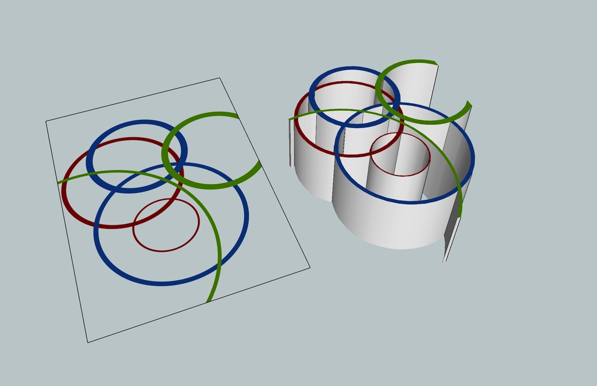

        hmm.. maybe ๐Ÿ˜‰
        are you saying you want to do something like this?
        the item on the left is a transparent .png while the item on the right is the same image with only the picture push/pulled (and the transparent part is ignored.. or, with a little more work, you could reverse that to where only the transparent part is extruded)
        if that's what you want then you should check out TIG's image trimmer plugin:
        http://forums.sketchucation.com/viewtopic.php?t=33445

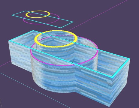

              I have that when I ask Textures
              Does this normal ?
              rvb.skp
              • jeff hammondJ Offline
                jeff hammond
                yeah, pilou. that's normal.
                the plugin doesn't convert each color of the png to its own individual texture..
                the texture still remains as one so when you push/pull it, that's what happens. (with my example, I painted all the vertical surface the default material but it looked similar to yours at first)

                  So Tig Must make a little addendum ๐Ÿ˜‰
                  • TIGT Online
                    NO. ๐Ÿ˜ฎ
                    What you do with the flat '2d' cutout after it's made is up to you...
                    You can Color any extruded surfaces as you will - but when extruded with PushPull it will take the top surface's material... BUT it has to assume something ๐Ÿ˜’

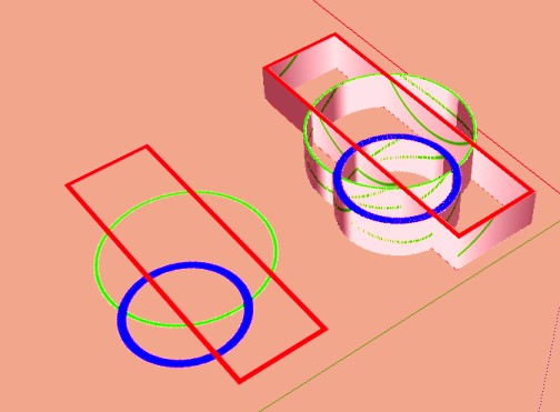

                        No just paint vertical faces with a solid color ๐Ÿ˜‰

                            I can also in view front just make a box selection from right to left for take only vertical faces and colorize them in one click ๐Ÿ˜‰
                            And copy past the top faces to the bottom if i want the same colors ๐Ÿ˜„
                              Easy and another time exploration is endless! โ˜€
