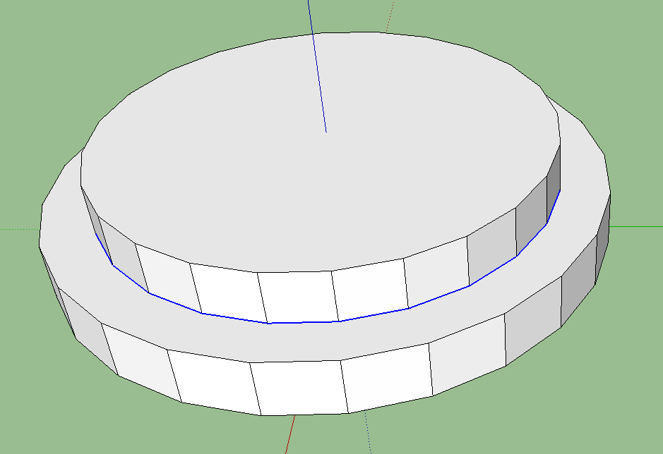

      I am looking for a plugin that works like "QuadfaceTools" by thomthom http://forums.sketchucation.com/viewtopic.php?t=39442 and its function "grow loop" or "select loop". I'd like to select entire loop as shown below - "select loop" from "QuadFeceTools" doesn't work in my example. If there is any plugin that solves my problem please help.
      https://lh6.googleusercontent.com/-AY2aree-sp4/T9bu9l4EajI/AAAAAAAACLU/9qgd1d5l49A/s1031/s1.gif
      The desired effect is:
      https://lh4.googleusercontent.com/-IMyjZklZZMM/T9bu9o7OF1I/AAAAAAAACLQ/aqDbK0ONj0w/s939/s2.gif

                @gilles said:
                You could try Recurve.rb, I don't remember where to find it.
                Thank you so much. Recurve (http://forums.sketchucation.com/viewtopic.php?t=36822) works fine. But how can I combine all selected edges into one curve? I tried weld tool without success.

                    Gilles,
                    It's not working. I still cannot transform connected edges into a curve. I've used Recurve Edges - it's not working in my example. I attached the file.
                    recurve.skp
                    • TIGT Online
                      Capture.PNGIf you first select the vertical faces/edges and smooth them, and then select the 'loops' Weld [or Recurve] will make the selected edges into a curve and then it won't be 'split' into pieces by the now-smoothed edges joining at the nodes...Capture1.PNG

                        If you soft coplanar it does work.
                        recurve.skp

                          TIG, gilles
                          Thank you so much!!!
                          Your first solution is exactly what I did πŸ˜„ But the second with smoothing edges is simple and works perfect.
