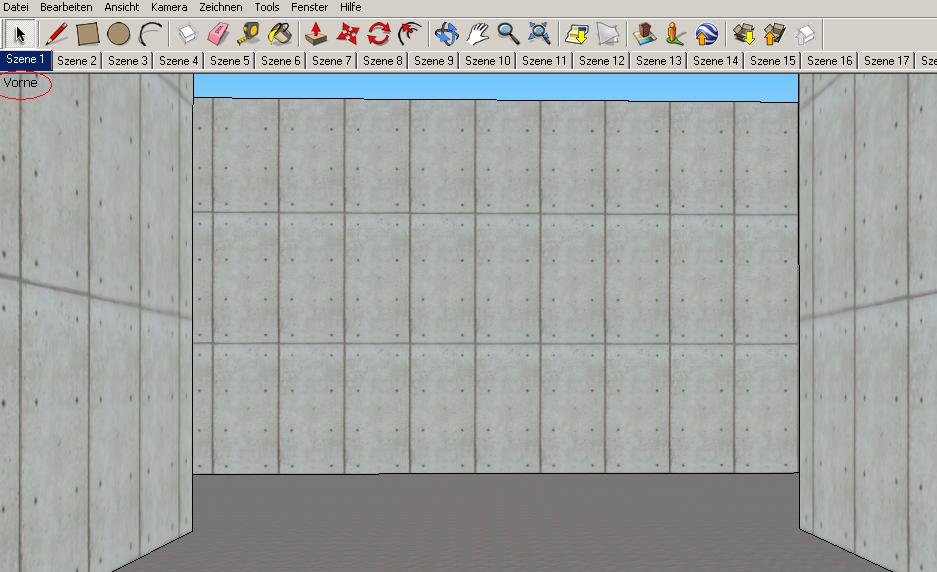

      Hello,
      At our institute we conduct experiments on navigation with Google SketchUp (Version 8).
      Unfortunately we can't get rid of the direction which is at the top left. (See picture)
      Does anybody know how to get rid of it?
      Thanks for any help!
      C.Wolf
      • TIGT Offline
        Unfortunately the view-text, saying Top, Front etc [or in your locale language], is hard coded into the SUp-code.
        Of course, if your views aren't these specific 'types' there is no text visible, so you could make slight adjustments to the camera to avoid them appearing in your [saved] Scene tabs...

            Right, it's an option named "ShowViewName" in the Ruby API, but apparently not available through any dialog. The following code, pasted in the Ruby Console window, will turn the text off.
            Sketchup.active_model.options["ShowViewName"] = false

              Thanks, that's very interesting. I couldn't get it to work, but googled it and found it was mis spelled. Should be:
              Sketchup.active_model.rendering_options["ShowViewName" = false]

                              • C Offline
                                C.Wolf
                                Thanks for your help everybody!
                                With the ruby console and the posted command everything is fine now!
