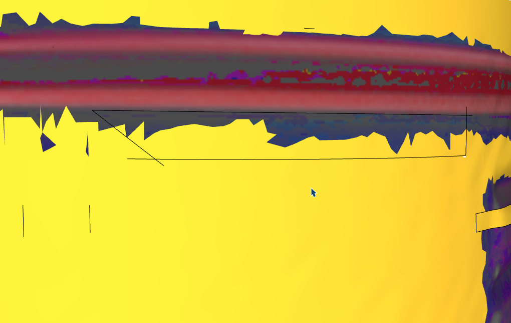

              Krass
              hello, I have a model with many polylines and the line tool doesn't work... is there a trick?I have a model with many polygons, and the line tool isn't working... is there a trick?
              It can't isolate these faces; I've also tried showing the hidden geometry. Sometimes it works, sometimes it doesn't.
              Krass

                  Rich O Brien Moderator @Krass
                  @Krass said in Tools on surface not working:
                  Can you expand on this? Is it that the enclosed area is not selectable?
                  • KrassK Offline
                    Krass
                    yes, i need to paint high poly surfaces, hard edges painting, but no way

                    • KrassK Offline
                      Krass
                      no this zone is not selectable as it should

                        SketchUp has limitations healing edges when they are below 1mm. Are you encountering that limit?
                        If yes, scale the object 10 - 100x and try drawing.

                          • KrassK Offline
                            Krass
                            I enlarged it by a factor of 100, but it doesn't work.

                            • KrassK Offline
                              Krass
                              Actually, it works better; I tested it elsewhere and the rectangle isolated the face well.

                                In 90% of edges not healing or holes not filling or missing it is edge size.
                                If you are importing scans it is best to x100 the scale to avoid this behaviour.
                                  I often work with a scale of 1000x. I can treat millmeters as meters that way.

                                    • KrassK Offline
                                      Krass
                                      Thank you: multiplied by a thousand, it's perfect!
