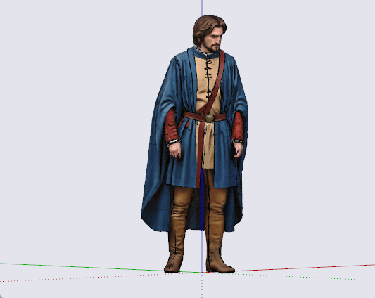

                      I use SculptTools to adjust the shape of AI-generated medieval characters. The problem is that the UV coordinates are lost as soon as the shape is modified. Preserving these coordinates would be a significant improvement.

                        Hello, that usual, I think the best way tu recover your mapping after modifying geometry is to select only the ugly faces and project your material with Fredo6 thrupaint

                          but I think you won't be able to do this with AI generted UV
                          • KrassK
                            Krass
                            One solution is to repair the damaged areas—like applying patches—using new material created from a screenshot of the figure taken before the modifications, and then applying it in "projected" mode using Thrupaint.

                                  no ! the best solution is to use SketchUV plugin!
                                  SketchUp_ZBpNK5VUlK.mp4

                                    If it's a single 'image' can you make its textured material 'projected', and then save it to another face of the same orientation. Can you then adjust the original surface - after which you use the eyedropper to select the projected texture from the temporary face, and reapply that onto the modified original surface ? hereby keeping the UVs ?

                                      That may be, but I don't see a faster, more effective, and free solution than the one I showed in the video above (the second one).
                                      • TIGT
                                        Your video arrived as I was posting - just consider it an alternative approach...

                                          Waoow ! Excellent !
                                          Thanks for the trick (SketchUV)
